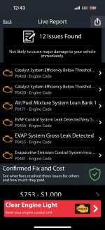

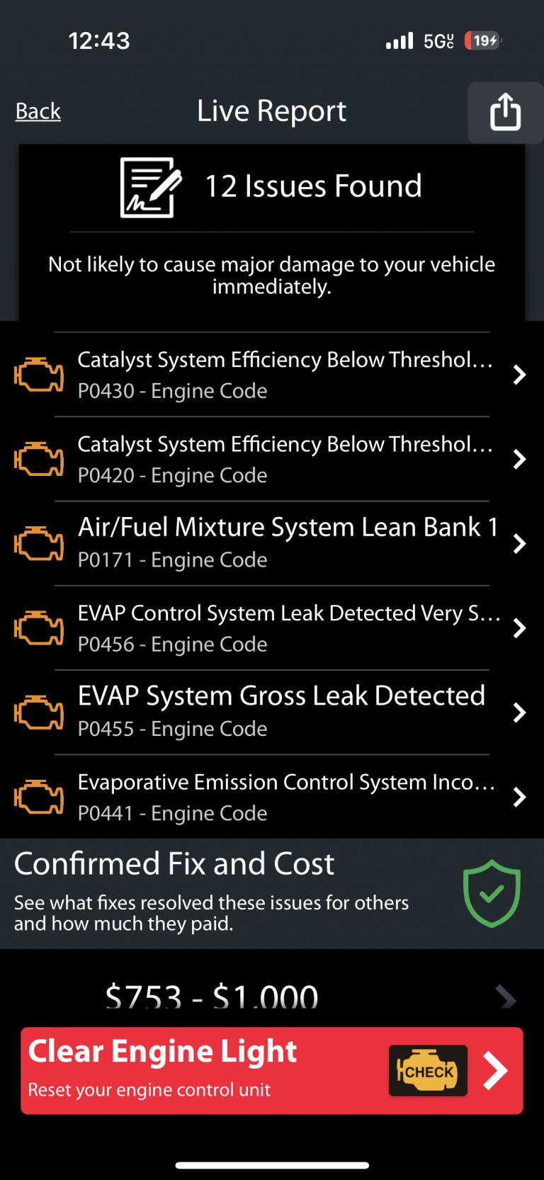

DT headers installed, now horrible mileage and 12 codes
I just got my DT long tube headers installed and now I’m getting worse mileage around the city and terrible mileage on the interstate. I’m driving the same was I was before the headers and I was getting an average of 16.7 MPG. Interstate cruising at 65 getting low 12-13. Also getting 12 codes.
You got intake and exhaust leaks. Work through your list, or get your
installer to do that, since they probably caused them.
