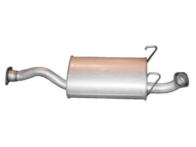

See how there's a small section of exhaust pipe between the 54681 muffler and 54081 tail pipe? That section of pipe broke off on your original muffler and is still bolted to your tailpipe,need to remove it.
This is a different brand replacement muffler,but shows the small section of pipe coming out the right side.
Got it now - So I will disconnect it there and find the hard ware for that portion to connect existing tail pipe to Muffler.
