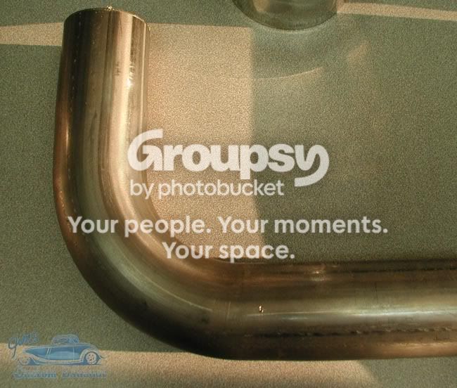

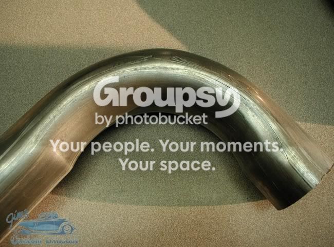

I've got a relative who is a mechanic so I'm going to get him to help me bend the tubing and such so I can get a bigger flow rate etc. I guess I'll go with the flowmaster. Please excuse my ignorance but what is a madrel bend? I like your setup trd_. Mine is very similar to yours without the rims but much of the custom dents...ha.
Mandrel bend keeps the uniformess of the tubing through the bend rather than distort the shape of the tubing... thus less restricted airflow.
Normal Bend
badbend.jpg~original
Mandrel Bend
good90.jpg~original
Also, have you listened to mufflers at all on 4Runners? IMO the flowmaster doesn't sound great on the 4Runner and their technology is actually outdated. I think the magnaflows have a much better sound but again this is only my opinion.
