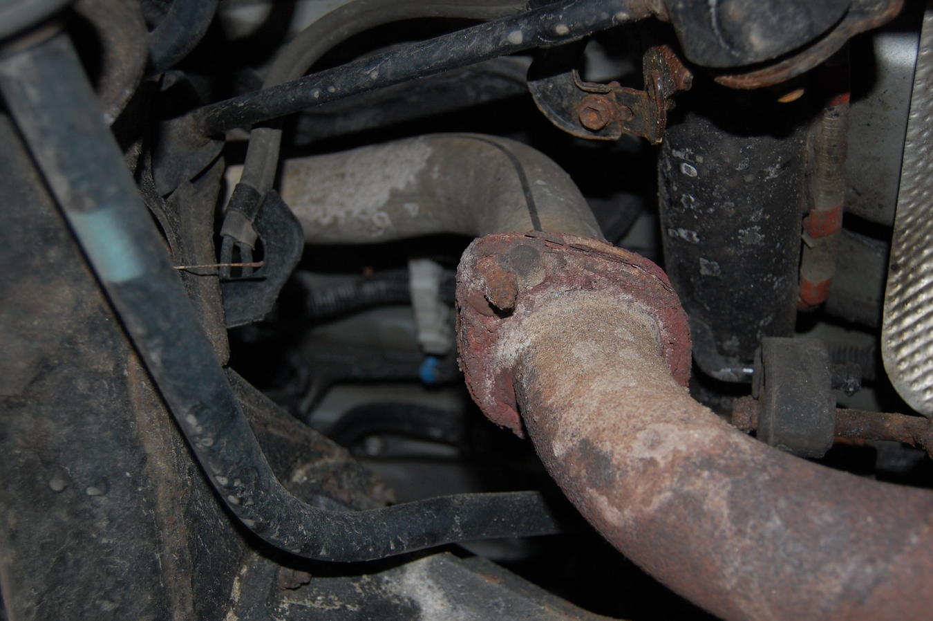

Update. Here is what I found a few days ago while attempting to get to the bottom of this noise. The area circled in red is slightly cracked, but not completely separated. Everything sounds normal. The crack is just enough to cause a ratttle when the exhaust vibrates. I used some cold weld epoxy (JB Weld) and it's fine again. Just as good as a welding torch I guess. Going to replace the center piece when I have time.

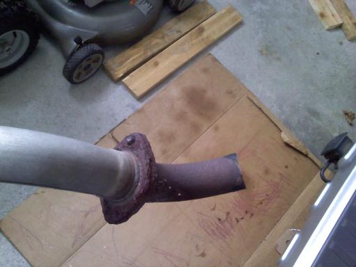

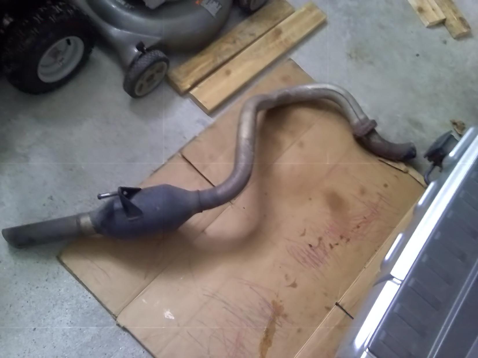

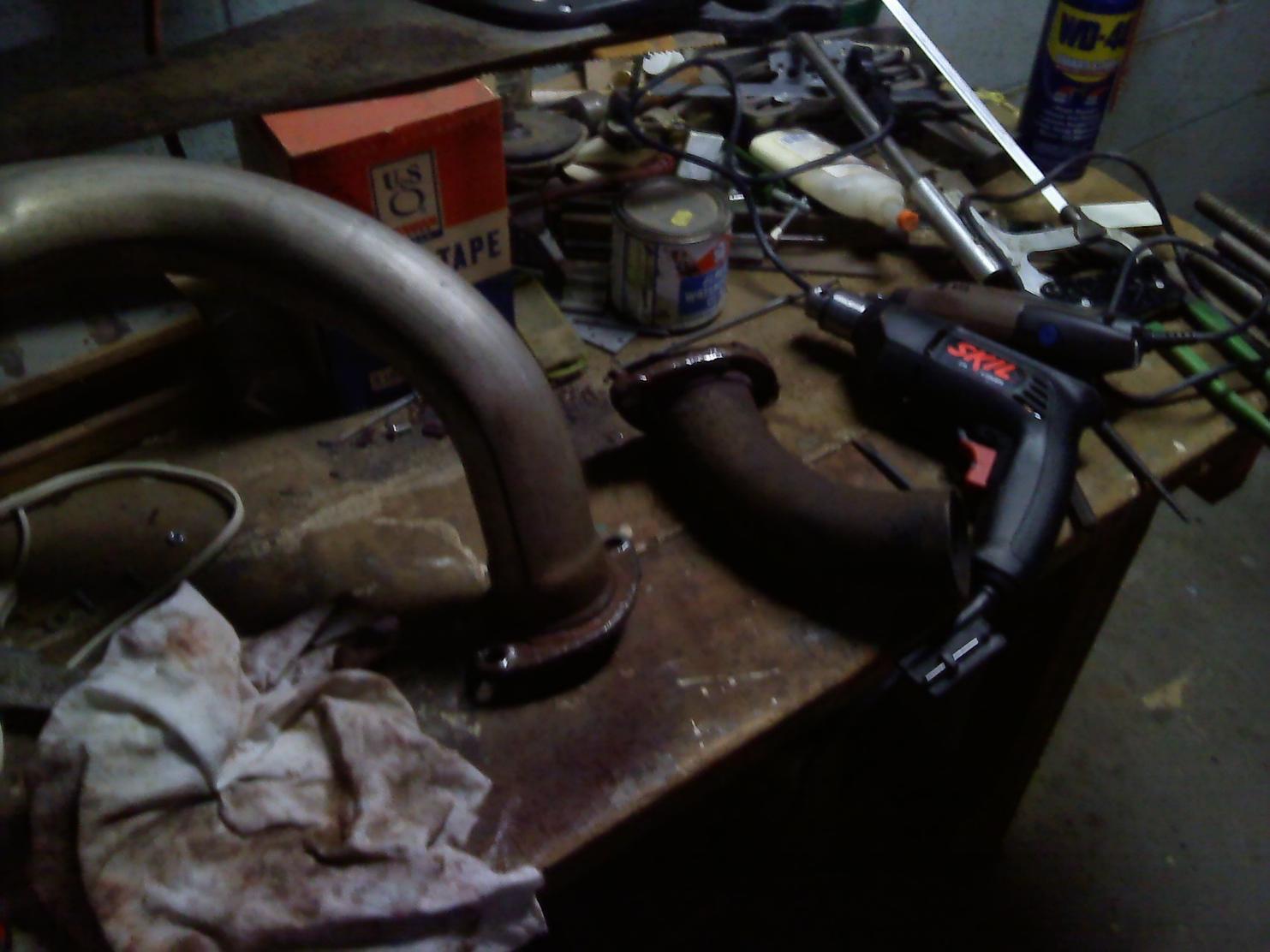

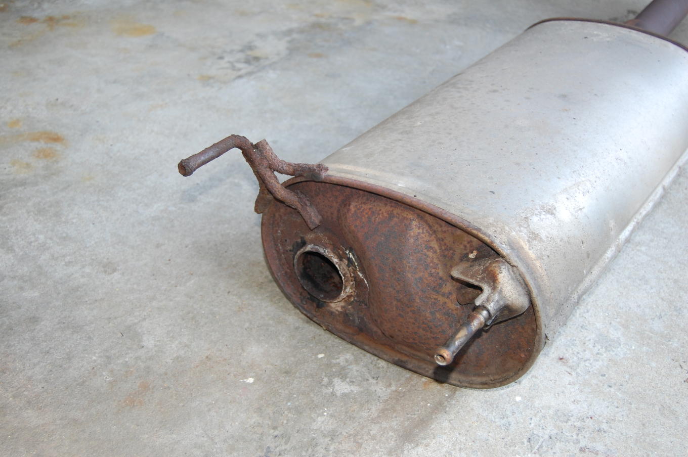

Well this is the end result of the exhaust. I guess The cracked section was too corroded to hold itself together for long so it finally broke off. I removed the rear piece and had a very hard time getting the broken piece separated from the good rear piece due to the corrosion. With a little patience, a dremel and a saw it finally came off. So I will replace the center piece, gaskets and bolts and should be good as new again. I attached some pics. Sorry for the quality. I took them with my phone instead of my regular camera.

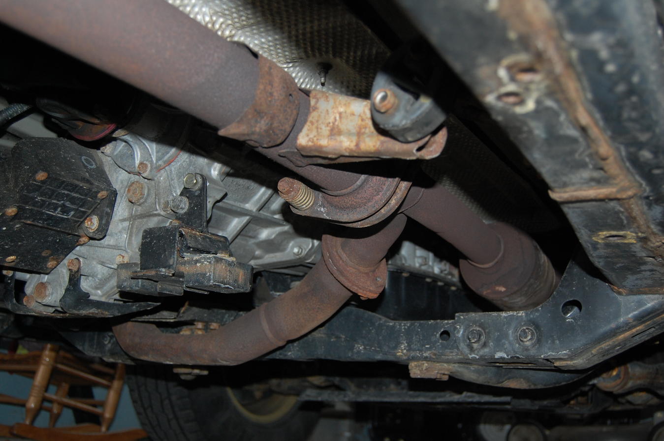

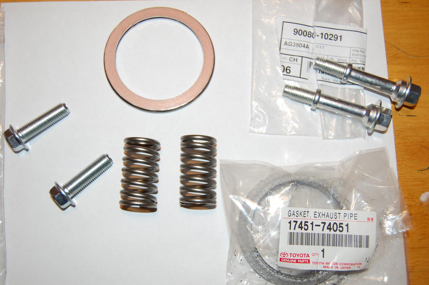

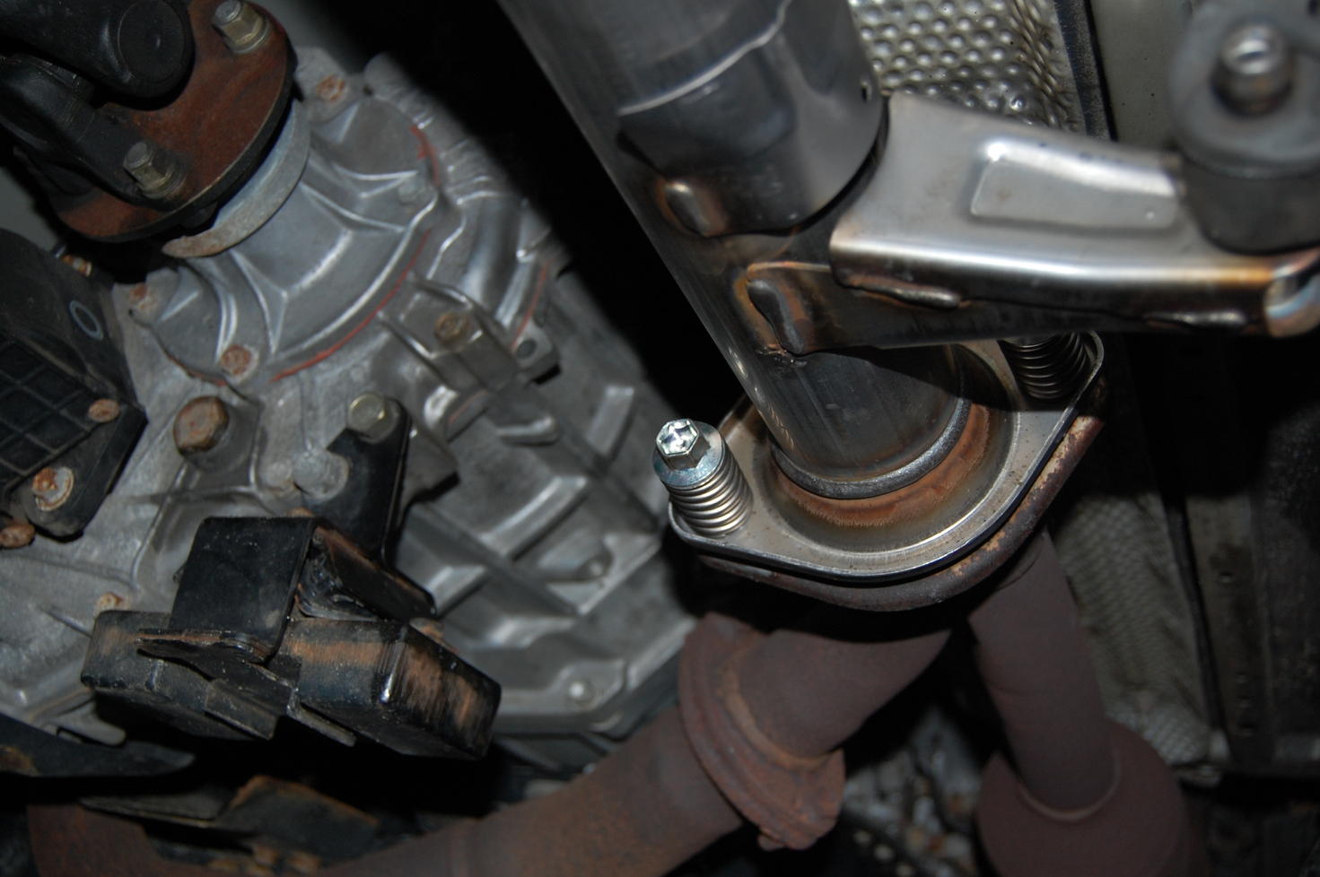

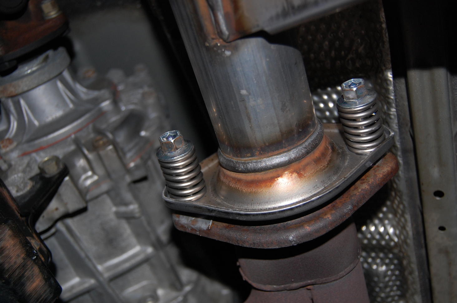

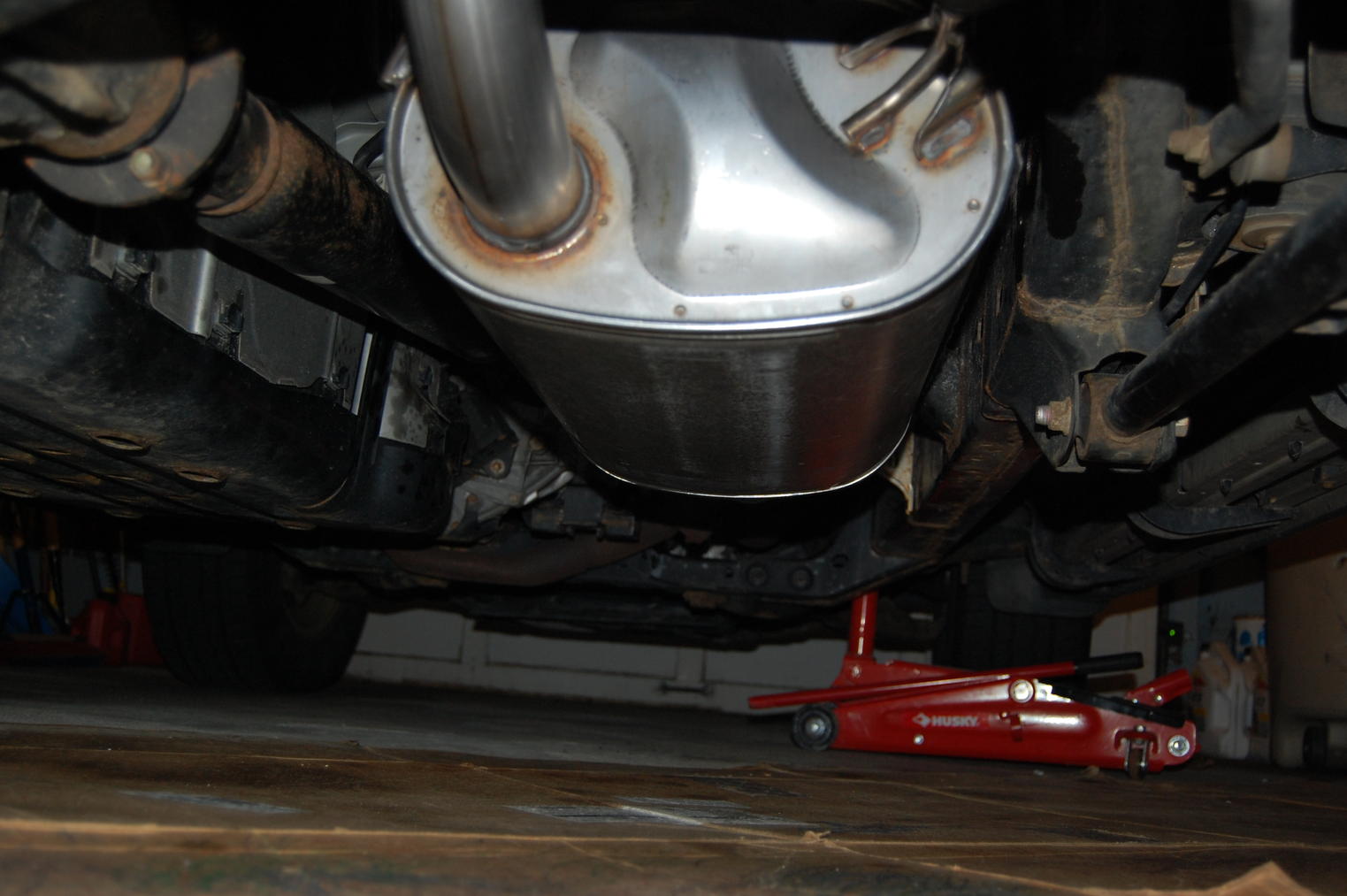

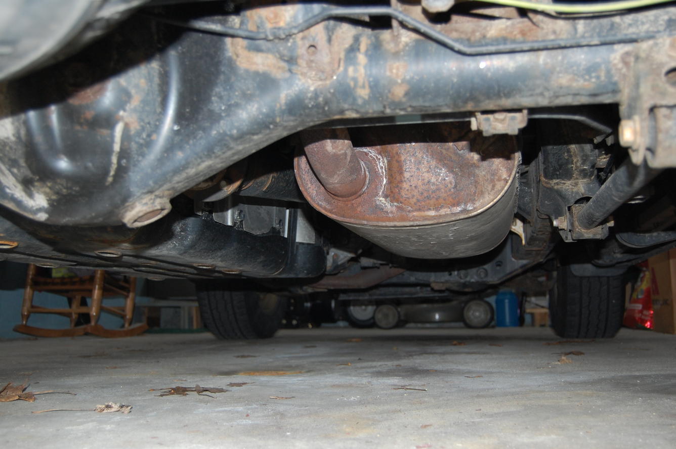

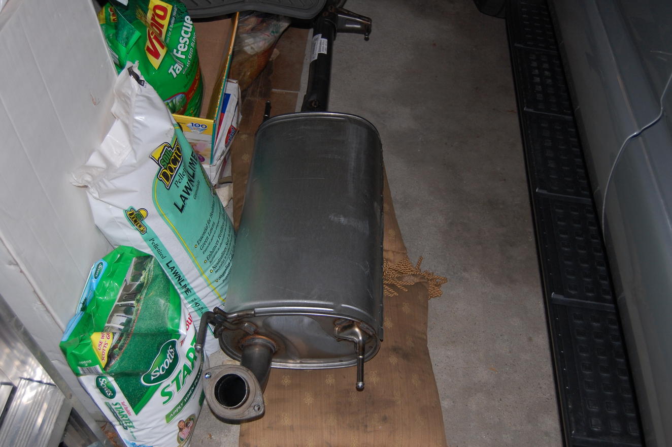

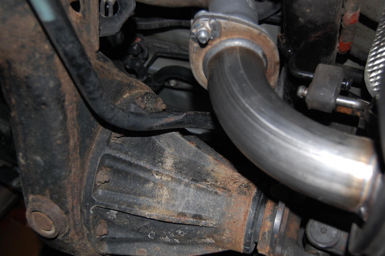

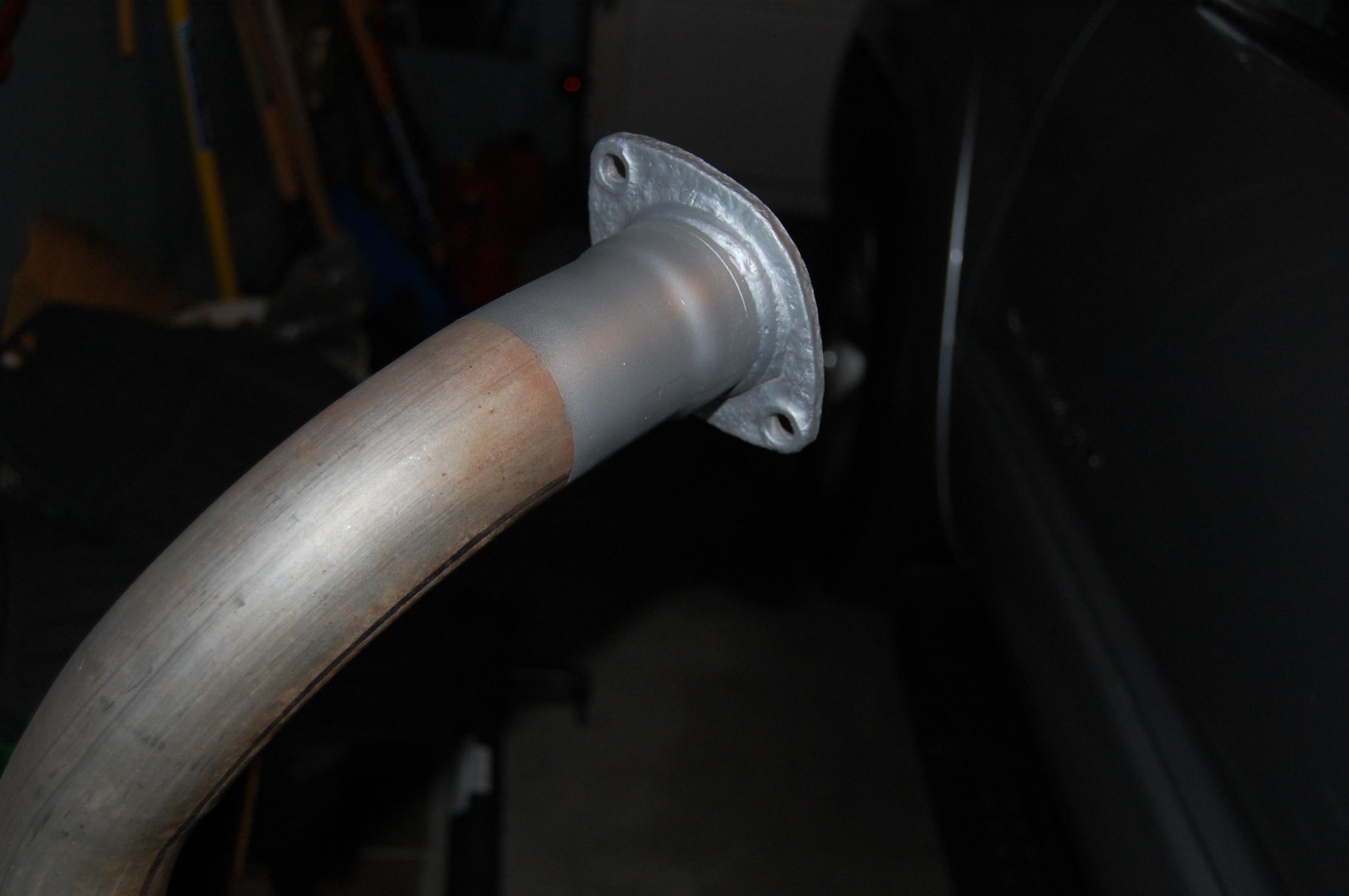

Installed new exhaust center portion earlier this week. The job was pretty easy and straightforward. Only part that sucks is that I started late in the evening and did not finish until after midnight and had to get up early to go to work the next morning. Everything is working great again. Here are some pictures...
