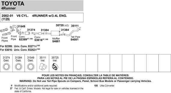

Here is a picture from Walker Exhaust with their part numbers. Stop by a place that sells Walker Exhaust and they should have them or can get them.
Front gasket: 31549
After front cat: 31374
After Second cat: 31384
