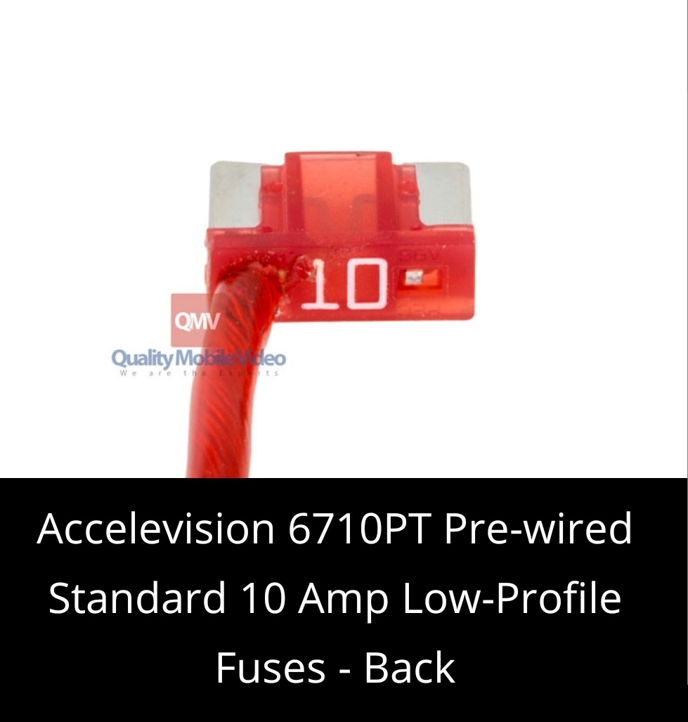

Bought these and don't need a new cover. they come in different amps and just run a new fuse at the end the wire

And how do you fuse the accessory you plug in exactly?
I can’t find any wiring diagram or description of this on the website.
Accelevision 6710PT Standard 10 Amp Low-Profile Fuses
But it seems that they just tap the wire into the load side of the fuse blade. So you are adding your load onto the existing OEM circuit load. Not an approved electrical practice unless your additional load is very small, like 0.5 Amps or less. Or if you install the fuse in the reverse orientation, so you’re tapping off the unfused +12V side, and you add your own inline fuse to your load. This is a clunky solution.
Plus you still cannot put the OEM fuse block cover on.
I don’t see any advantage to this.
The tap goes on the hot side of the fuse so has no effect on the wire going to device of choice. It’s doing the Same the exact same thing as the add a fuse tap without the bulk. As noted you add a fuse at the tap wire. Cover fits fine , the wire bends at a 90 angle
Too much work. I'd rather use an add-a-circuit and either leave the cover off or wait for an extended one.
That’s cool that it works for you. If you have time could you snap a couple of photos of it installed in the block showing how you formed the lead, and how it comes out under the cover? This may be a good option for people who only have one or two circuits to deal with.
