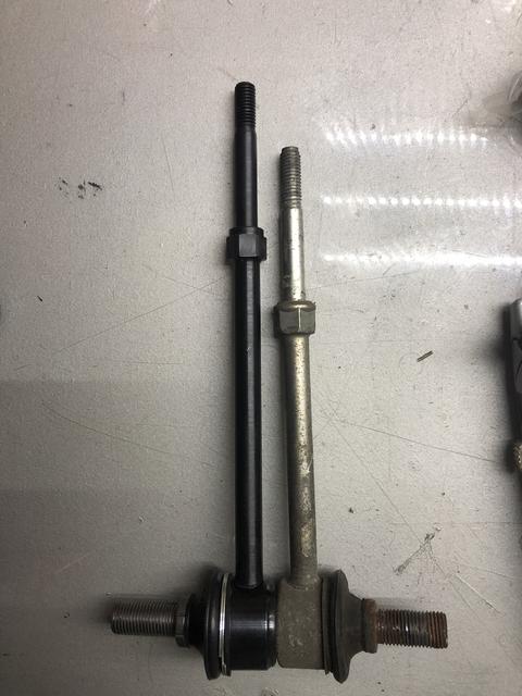

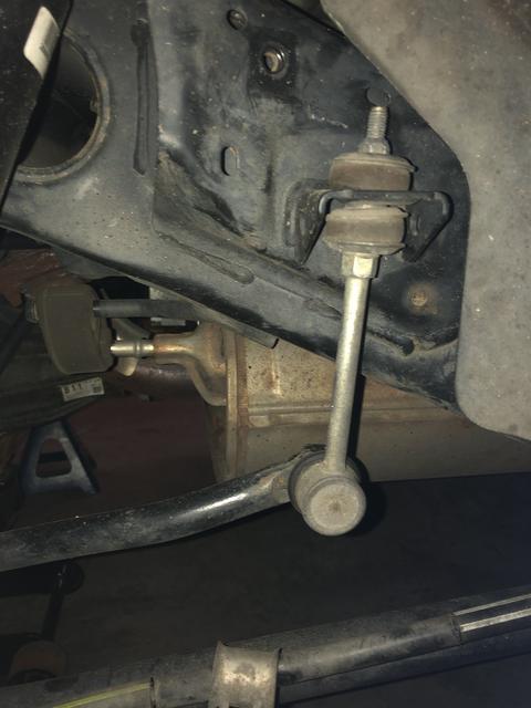

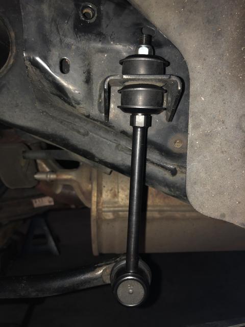

Amazon delivered the links a day early and I have put them on. Everything is same OEM ones, just about 1-1/16” longer. I think they worked great. Eliminated the awkward angle of the OEM links due to my lift. About 2” clearance with the trailing arms. Very satisfied. Big thanks to [MENTION=126566]jwkilgore[/MENTION] for posting about using these links. A lot cheaper than adjustable links.
Comparison between OEM and new links
OEM
New links
