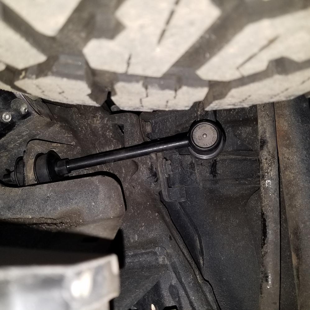

Well since Amazon FINALLY delivered my links after a 12 day wait, I got them installed. Here's what they look like with a 1.5" lift. Please ignore the filth. It usually doesn't look anything like this but with the cold weather here It's too cold to wash anything. Can't wait to get it up on 4 jack stands, pull the wheels and tires off, and clean it top to bottom.
On a side note, anyone else notice these Moog links are made in Japan?

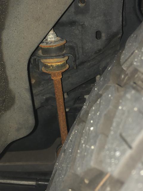

So who else has noticed these links are rusted to hell in no time at all? Looks like they've been under there for years even though it's only been a few weeks. WTF Moog? I will be removing them, sanding them, painting them, and reinstalling them. For anyone buying these new, I highly suggest you clean them up, prime and paint them before install.
Yep. Be doing some painting this weekend.
