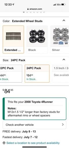

That all being said does anyone have any other options? I’ve found these supreme studs on Amazon but I’m not sure if they’ll actually work on a 4Runner as I think they are listed for a 2nd Gen Tacoma?
Amazon.com: Supreme Suspensions - 12x Extended Wheel Studs Kit for All Toyota Tacoma with M12X1.5 Studs [Front or Rear Wheels]: Automotive

Double check somehow but 2nd Gen Tacoma’s and 4th gens take the same wheel bearings, so studs should be the same as well.
Edit: they should work.

Thanks for this! I was looking on my phone and didn't get that little noti down there. Cheers bro!
