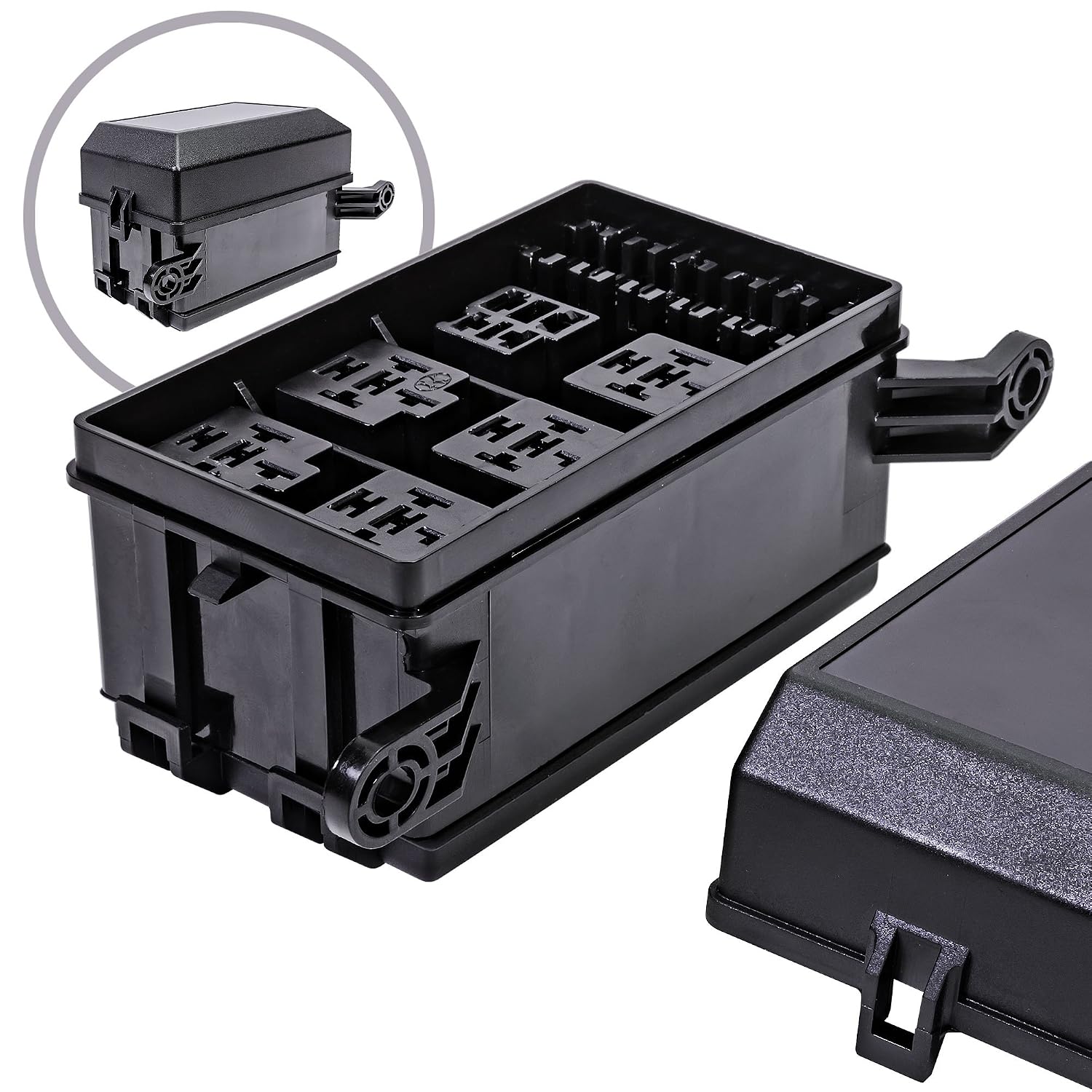

I know there are TONs of threads of guys doing this, but I've not seen anyone using a box like this yet
It looks interesting to me, wonder where it could fit nicely...
If you don't have an 01 or 02 and have all the EVAP stuff and the abs on the passenger side then basically nowhere in the engine bay that is convenient to work on. I was barely able to fit the blue sea box in my 98
I used a 12 slot Blue Sea and mounted it up on the firewall a little off center. There is a place just big enough to fit it there.
I have seen some people putting it on the of the existing fuse box as well.
I used that box on my buddy's rig, and another member used it on his 3rd gen. Look in my '01 thread. He posted pictures in the last page or two.

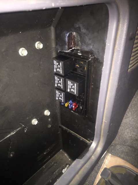

I got an email ya'll were talking about me. I used it on my 2nd Gen in the rear storage compartment. It runs my rack light madness

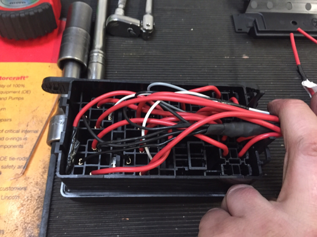

Easy to wire up with some patience and the right crimpers
