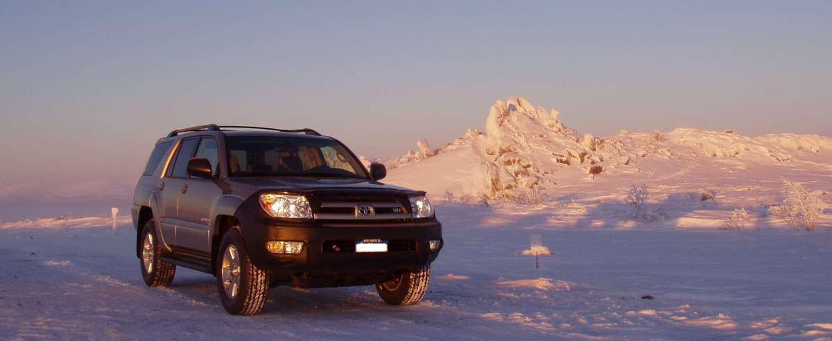

Hey all,
Just back from a trip north of the artic circle. Here's a couple of pics before my radiator froze (while driving).
brrrrr!

And another, just before I had to deal with the radiator...
Now you have to tell us the story of what happened when your radiaor FROZE, while driving no less! That is damn cold!

Yeah I kinda didn't tell the whole story. So here is the skinny: I was coming back south to Fairbanks from just north of Coldfoot. Coldfoot has the lowest recorded temp in North America -88F (without windchill) and we don't talk about windchill up here. Now, I really don't know how cold it was 'cause the Toyota thermometer only goes to -22F, and it spent a lot of time showing that temp, but occasionally would show me -- (no numbers). I'm guessing it was at least -50F. Of course, when the radiator freezes, the engine overheats because the is no circluation of coolant in the engine. I actually "saw" it happen (luckily). Temperatures can vary wildly on this highway, but generally depress in the valleys. I was going down into a valley and the steering stated to get a little sluggish (happens a lot up here, so it's a heads up to start watching the gauges). Sure enough, the steering started to get really "stiff" and then the temperature gauge shot up within 30 seconds to the red, I immediately pulled off to the side and shut off the engine.
After throwing my spare Carharrt coat over the radiator cap I loosened it--steam everywhere of course, and a fair amount of gurgling.
Let it sit open for about 5 min (I sat iside the car where it was warm). Turned the key to on (but not start) saw the temp had dropped to the middle again. Checked the fluid level (got lucky there), replaced the radiator cap, stuffed my coat in front of the radiator, closed the hood and was on my way again.
As for the bra, no it does not help keep the radiator warm. But, in the summer time this road is gravel (big gravel), and semi trucks trucks throw good size rocks right at you when the pass from the opposite direction, the bumper catches probably 80% of them and they can leave dime-sized chips in the paint--So, a few bra rubs (in my mind) are minor in comparison... Besides, I wouldn't want to leave my girl "exposed" in such a harsh place....
Oh, yeah, I almost forgot. the "fix" for the radiator is to put something in front of it. People have used cardboard, aluminum foil, closed cell foam, etc. I SHOULD HAVE DONE THIS BEFORE I LEFT FAIRBANKS.
Probably more than you wanted to know, but there it is.

I've seen zip up radiator covers on semi truck for years. Never though about needing one on something smaller but it makes sense. I'm a little slow this morning. How does popping the radiator cap help unfreeze the radiator?
Do you have a block heater? Any other weather specific add ons to your rig?
If your radiator was frozen, how did you thaw it out enough to continue driving? I mean, if it was frozen and you are in -50* weather, putting your Carhartt in front of the radiator would not have been enough to thaw the frozen radiator.

Did you ever consider removing your thermostat in really cold weather?
Without the restriction of the thermostat, the coolant will flow at a higher rate, which will make freezing unlikely. Your engine will run a little cooler than normal, but your radiator will be warmer than normal.
Also, instead of running a 50% mix of antifreeze and water (which typically protects only to -26F) you should put 2/3 antifreeze and 1/3 water in your radiator, which should protect from freezing to -76F
Your radiator will never freeze again... not even in that place!!

Removing the radiator cap releases pressure, which is an exothermic reaction--gives off heat causing things to cool. Kinda like removing a bottle cap from an extra cold beer, liquid when sealed but open it and ice crystals form...
Yeah, I got all the cold weather stuff: block heater, oil pan heater, battery heater/trickle charger, etc. I had a zip-up vinyl cover for my 93 4Runner radiator, and it worked okay. Haven't seen any for the 04's though--can't imagine they would look good. Going to customize one out of closed cell foam. Since there is plenty of room under the hood it won't even show.

Okay, as from my last response... Uncapping the radiator doesn't "unfreeze" it per say. That happens when you stop the car and the wind isn't so intense on the radiator. However, uncapping the radiator does release pressure (see last thread response) and causes the overflow resevoir to be "sucked" back into the radiator--also helping to unfreeze it. Keeping the radiator cap off helps to cool the engine (see last thread). All kind of twisted and conter-intuitive.
Never tried removing the thermostat. Since shielding the radiator works quite well, no reason to risk it by removing the thermostat.
The dealer here claims that they winterize all new vehicles to a -50F antifreeze mix.
Probably the reason I was able to thaw my radiator so quickly was because I caught it early, before it was really, really frozen.
Finally... This is Alaska, I've learned to not say NEVER, ever.
Probably the reason I was able to thaw the radiator so quickly was because I caugt it soon enough, before it was a block of ice. Putting my coat in front of the radiator did not help to thaw it, but did help keep it from freezing again.
