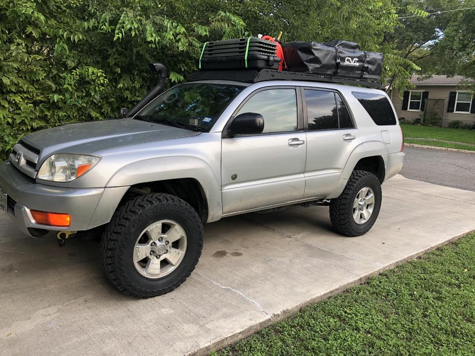

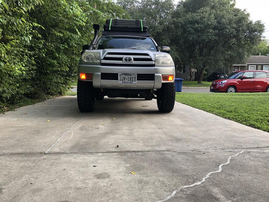

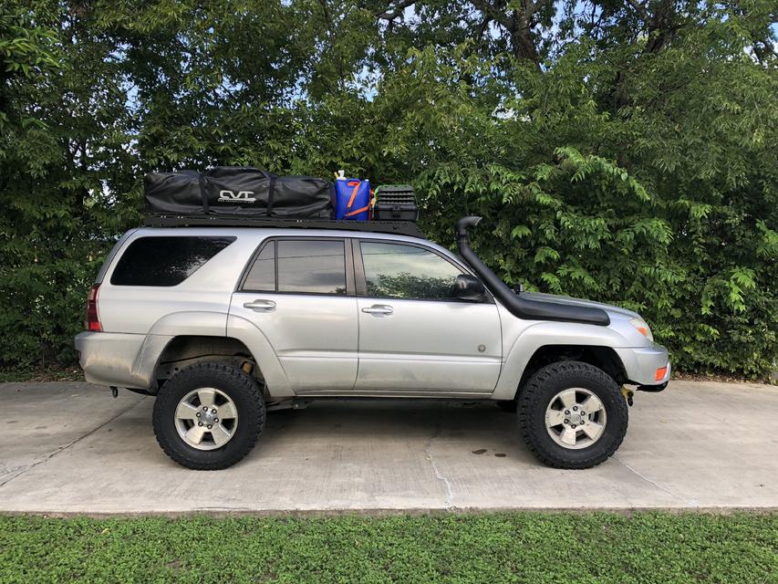

Current pics, read below for the progression to this point!
Hello all! I just purchased a 2003 4x4 T4r a few weeks ago. Been in the Toyota world for a bit, had a 2010 Tacoma with an OME lift on it and some small mods. Loved it, but my wife and I have a new baby, and we didn’t really need a truck worth 15 grand anymore as my backup commuter vehicle.
So I sold my Tacoma and bought this baby for $6100. It’s got 197k miles on it, so lots of stuff is getting a little worn down. That said, I don’t think it’s ever been worked or driven hard. It has been a grocery getter. Exterior is probably a 8 out of 10, minimal scratches, tiny bit of sun damage. Interior is probably the same, excluding the cracked dash. Runs well, engine feels smooth and even.
My big goals for this project is a capable off-road/camping vehicle that is reliable and running like a top.
Big picture goals include a roof rack, RTT, drawer system, and a DIY front and rear bumper with winch etc. that’s not going to happen till next year, this year is more about an intensive maintenance regimen to get it up to speed.
This is as she sits today. I’ve already done some small things to her, but everything’s basically stock. It’s not going to stay like this for long.

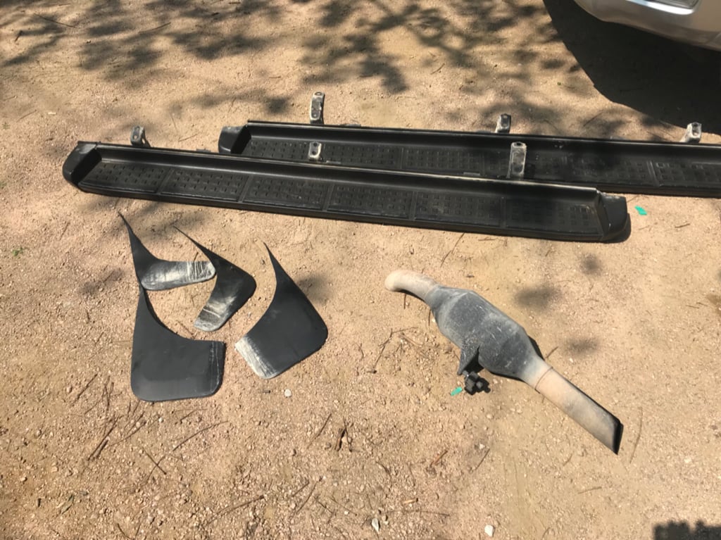

Mud flaps cut
OEM running boards removed (pm if interested in buying them from me)
Resonator deleted, tail pipe cut at axle

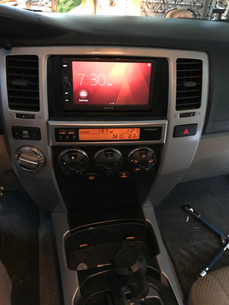

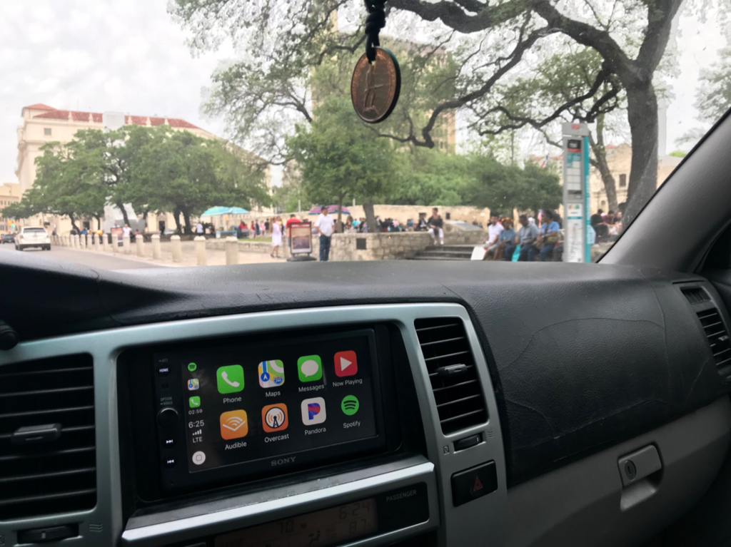

I was bored and I figured “hey I’ve got that head unit just sitting here, why not throw it in?”
Well. That would have been a 45 minute process, except the previous installer or my current craptastic unit cut 3 wires directly out of the oem harness, and rigged them into an old pac unit. Head unit works perfectly, sound only comes out of left speakers, and steering wheel controls don’t work at all.
Gonna call Crutchfield tomorrow and see if they can help me figure it out. If that doesn’t work, I’ll take it to a stereo shop, get them to help me fix the wiring and put it back together myself.

Fixed my headunit. Sony XAV-AX100. It’s awesome. Works great, steering wheel controls work perfectly. No buzzing or audio issues and CarPlay is great.

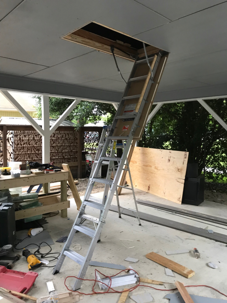

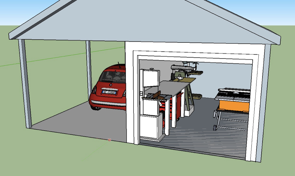

Started building my workshop, which needs to be finished before I can start really working on the 4runner. Installed an attic ladder in my carport attic so I can access the attic while building the shop.

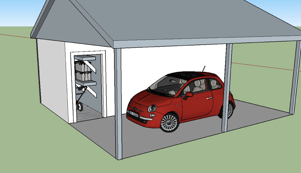

And for those who are interested, this is roughly what the shop will look like. The design has changed some since this rendering but this is the basic idea.
Yes my wife drives a fiat. Yes it’s a terrible car. And please for the love of God dont ever buy yourself one. But it’s cute and red so here we sit :).
