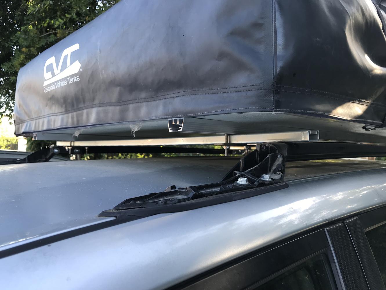

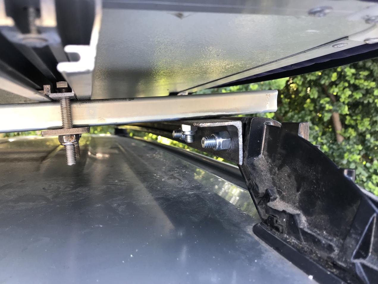

Spent $30 on some unistrut, angle, and some bolts for a temporary RTT mount. Mounted the RTT last night, because I'm excited, and impatient, and that's WAY more fun than framing on my shop (which is probably what I should have been doing).
I also broke all 4 plastic covers on my stock rails. Doesn't really matter because the entire thing is coming off in a few weeks anyways.
Also, as an aside, if anybody is hurting for a cheap rack setup, I'd be happy to let my entire stock roof rack, stock crossbars, and my new "HD" unistrut crossbars go for $100 bucks or so. Just something to help cover the cost of my new bars plus a bit. Its all coming off as soon as my prinsu rack comes in.
ALSO, mounting a RTT sucks. My knuckles hurt a lot this morning.

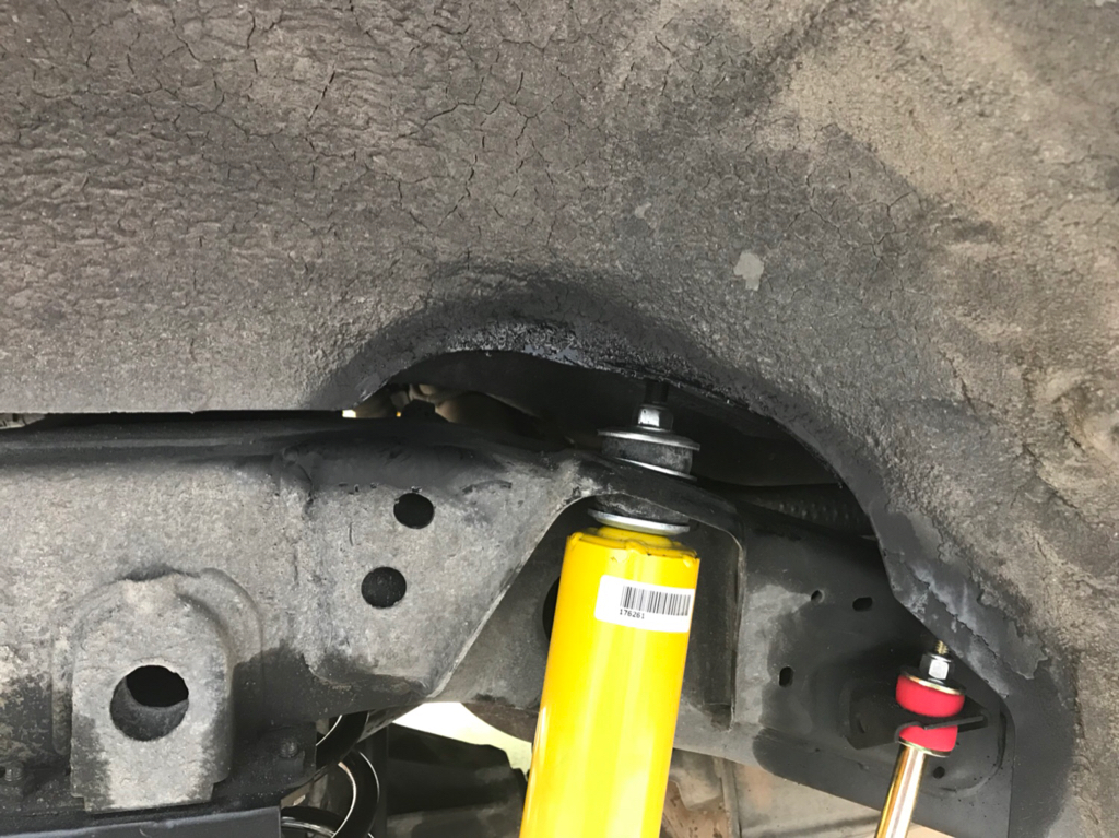

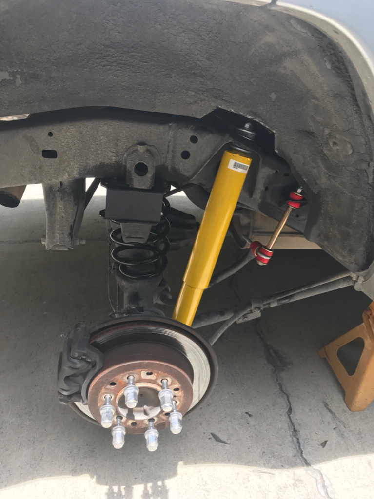

Best thing about working on a truck with 200k on it? Doesn’t matter if you take a grinder to it. One of the pics above show an earlier rendition of this cut I made to improve access to the shock nut. After everything was done, I went back and cleaned everything up, smoothed out the cut, and painted to avoid corrosion. I didn’t cut into the pinch weld at all, just trimmed the inner fender sheet metal a bit. Helped SO MUCH. just used my angle grinder.
0bf3bbd018fcaea1450fb2b35c76cc2b.heic
f0fe0d754f9a2a982ae564fdbdf162ea.heic

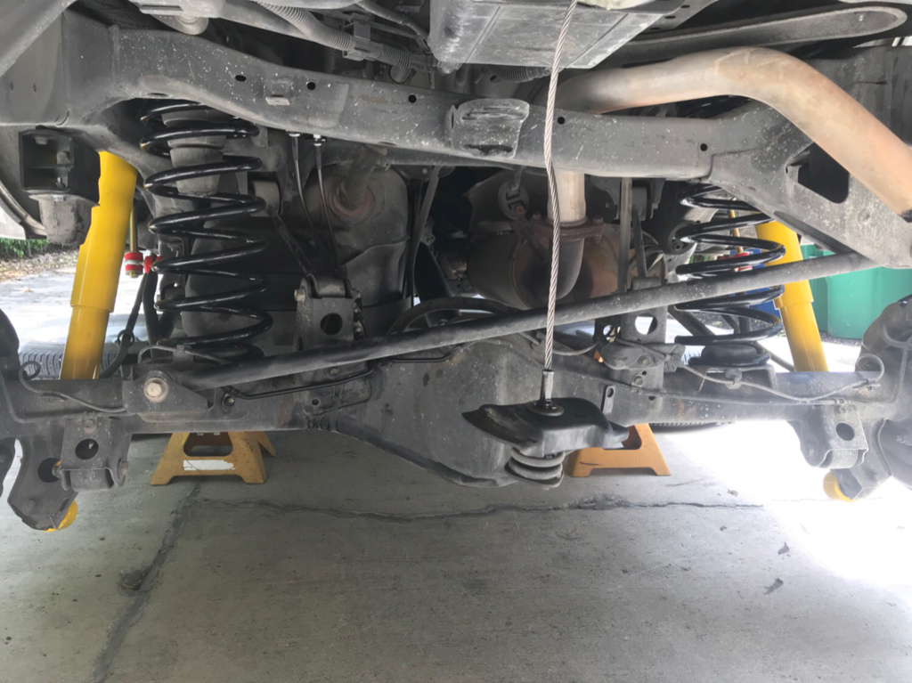

Rear is done. I might or might not have used ratchet straps as spring compressors to get those bad boys up in there. Do NOT try this at home.
I also had to use the stock bottle jack between the bump stop and axle to push the axle down on one side, while pushing it up on the other side with my big jack. It was fun. Getting stiff, tall coils in there is a chore.
27745ca8a2779dd7ae7b12187dc36e70.heic
No pics, but I also installed extended rear brake lines, also you can see the metal tech bump stop extensions and DIY sway bar link extensions too. Supposedly 2nd gen sway bar links also work. I’m happy with this approach. The one additional thing I did was double nut the inside of the eyebolt where it attaches to the sway bar. I also used red loctite on the outer nut.

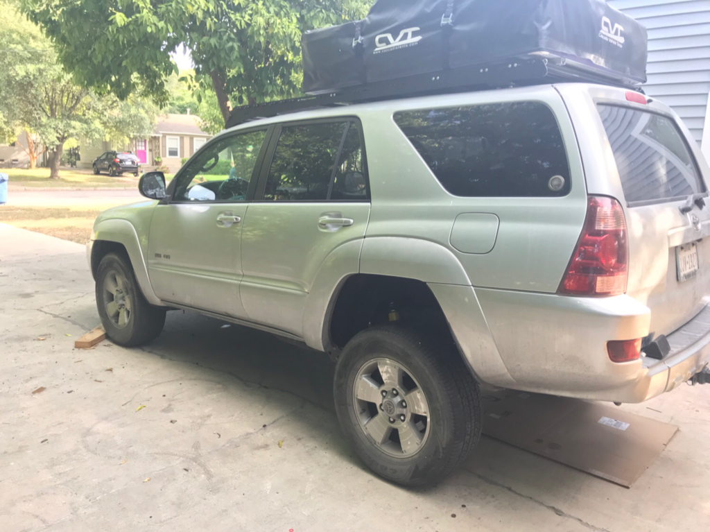

As she sat Saturday night:
09dd8390b70ca7ca2f3dad95831f1270.heic
aa72dcb059e425fdb7d9b84db707cfaa.heic

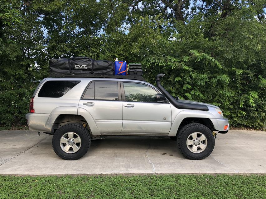

Again, lots of changes since my last post here. Been doing a lot of working, lots of playing with the rig, and not so much posting.
Things that have happened since my last post:
-Dobinsons installation completed, including UCA's and diff drop
-alignment
-$1600 worth of AC repairs, spread over about 6 different visits to my mechanic, but the AC is now working. Evaporator and condenser ended up getting replaced.
-New drivers hub, couldn't get alignment done without it, so I had the mechanic do it for me
-new inner tie rod end-still need to go and replace the other inner and both outers, but they're fine for now.
-new oil pan, old one was leaking, it had been driving me crazy, and mechanic gave me a good deal on replacing it while it was getting the AC work done.
-LC80 snorkel installed, intake completely sealed going into snorkel
-Cali-raised sideshooter ditch lights on Rago fabrication brackets installed
-amber Lamin-X installed on fogs and DRL's
-rear diff breather extended up to gas tank lid
-front bumper cover trimmed, and front mudflaps completely removed, because the new tires were rubbing a bit on them.
-the "40" part of the 60/40 rear seat completely removed, in preparation for a some cargo compartments/platforms we'll be making and installing this winter. Now our cooler lives in that spot for trips. Super convenient.
-1.25" spidertrax spacers installed
-255/80/17 Cooper ST MAXX tires installed-still need to play with the truck with the suspension flexed, I have a feeling I'll end up doing the BMC to avoid any rubbing while stuffed. Also got a 5th one installed on the spare, and barely got it stuffed back into the stock spare location.
-Plano all weather case mounted to front of roof rack, now holds all recovery gear
-Got some X-bull traction boards-not really a mod, but directly effects our ability to go offroading and exploring by ourselves, so there you go.
-We've gone on several trips, played a lot with gear organization, and I've succeeded in getting most of my emergency gear and tools that live in the truck stored in small compartments, so that they're readily accessible and not floating around in the back.
