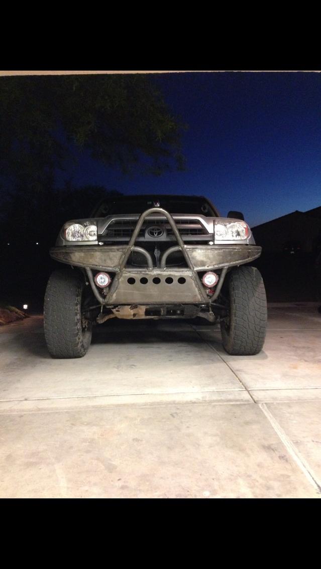

Fabricating my first off road bumper for my 05 v8
Well I had some time today to make my winch plate.
I thought maybe I should keep it like this for a a while. It would be the best road rage tool
Now I think it's time to start building the tubular part!!
Finally picked up a winch so I can finish my bumper! Ended up picking up 3 warn winches. 1 m8000 and 2 vr8000 that needed parts. First up was mounting the winch.
I go to a school that has a very nice digital pipe bender so figured out what angles I needed and boom
Then came making everything look right. This is my first time ever doing this so I was winging it big time. Tacked it up to where it looked rightish.
Im very happy with the outcome. Still have lots to go. I'll get better pics tomorrow.
Looks great. I appreciate the thought and effort that goes into customizing a piece for your application and being willing/able to do the heavy lifting to get it done. As a noob I have a question. What is the purpose of the big hoop in the center?
Compensation.
KIDDING. It's there to protect the radiator in the event of a rollover.
I just saw them on jeeps and thought they looked cool lol. I always though they were for pushing thru shrubs and what not but protecting the radiator makes more sense lol. It looks better in person imo it is huge but this pic makes it look larger.

Nice man that looks nice. Ya its the first time I have ever attempted to do something like this so I'm stoked I can call it my own. Still got lots to do. It's a great felling hu?
Also might cut that hoop down a little.... I'm playing with the idea.
Bumper looks great! While the big hoop is something I think is pretty cool, I think it would also look really nice if it were cut down to be a little taller than the top of the grille.
