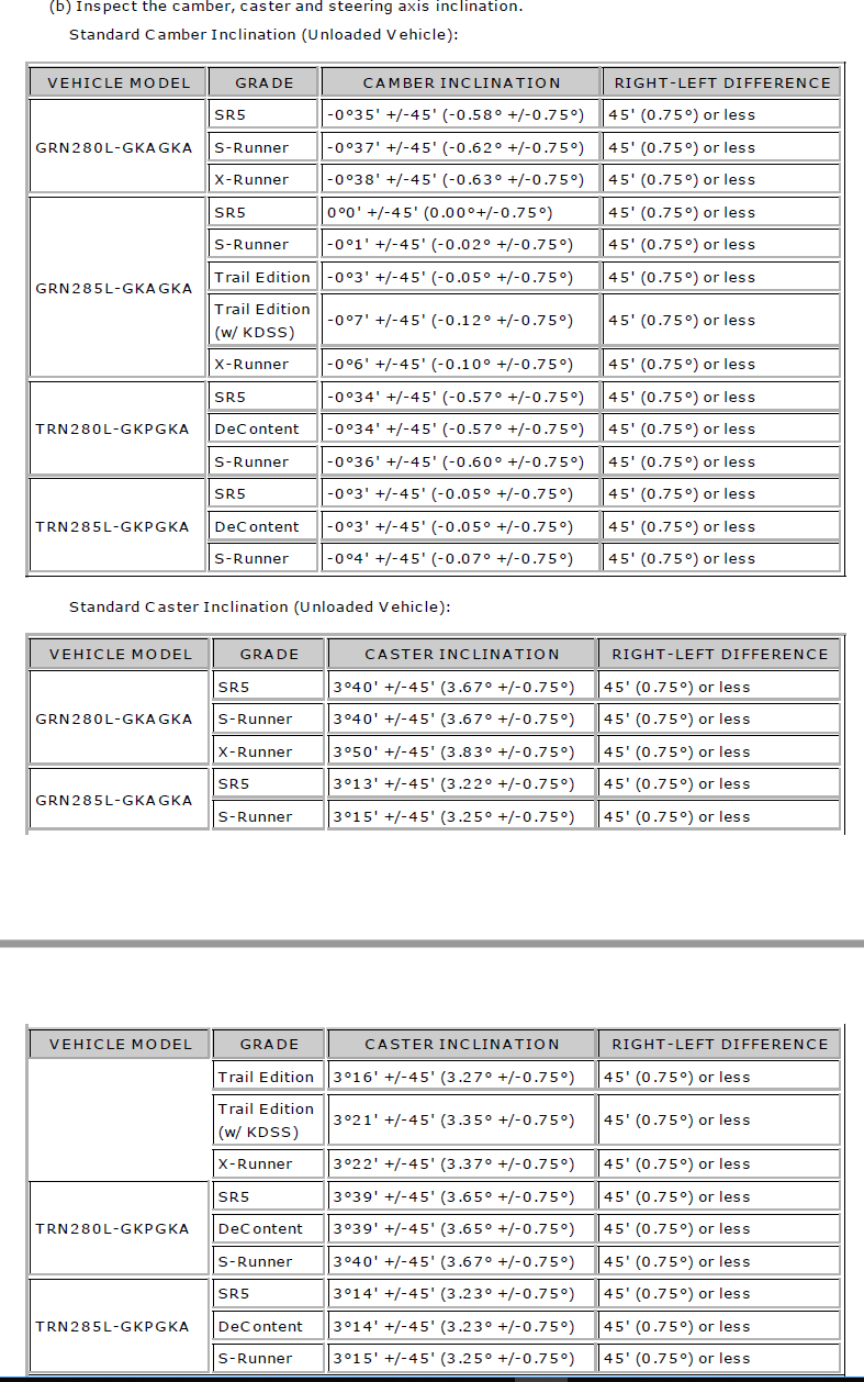

Taking my 19 4Runner back to the alignment shop in the morning.
I want them to set camber and toe to within factory specs, and caster near 4°.
What are the factory camber and toe specs for the 5th gen 4runner?

The specs for SR5 vs. KDSS vary slightly. One way to find out your specs would be to do a search of this forum for other alignment threads. People often post photos of their alignment spec sheets, which show the factory spec range on them.
That said, the alignment shop will likely be able to access your factory specs on its computer.
As a side note, you probably won't be able to achieve 4º of caster with any sort of lift using stock upper control arms (UCAs).

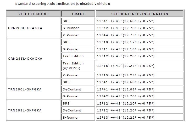

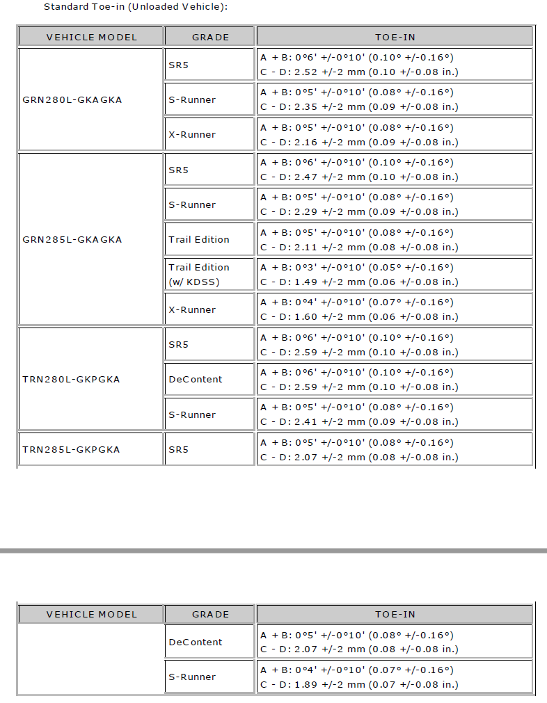

From the service manual
steering and toe:
