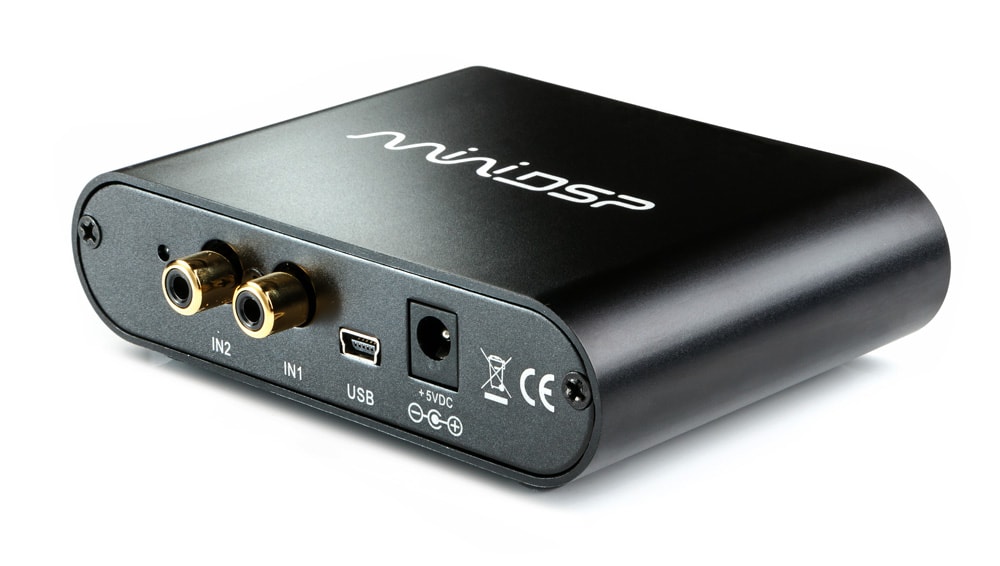

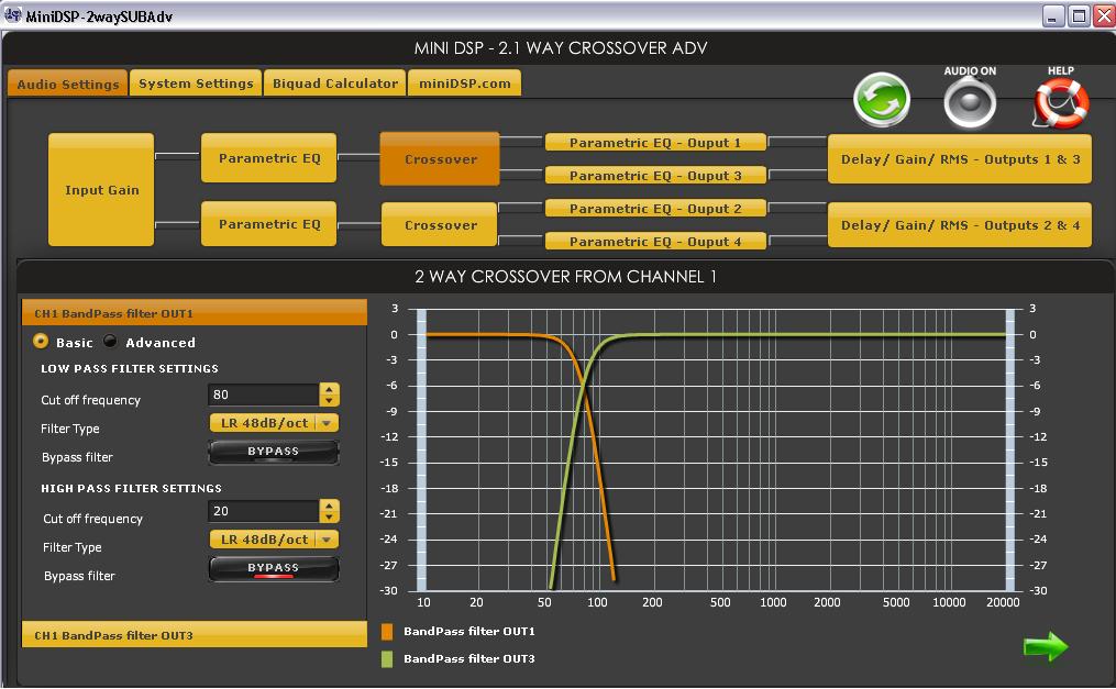

Hi Ruski,
Most people wouldn't use as much power and hardware as I use for the bass, however, being an R&B/fusion bass player, and audio aficionado, I've had my standards set a bit high regarding genuine bass tone, and find it hard to compromise with sound quality to which I've become accustom! To answer your question... you would only need to add an LOC to manage the input signal level! To address the other issue of EQ/X-over... I didn't want to add anything unbecoming to the dashboard or passenger area so I decided to use a laptop based 'miniDSP 2x4' processor.
It needs only a 2 x 2 x 1 inch filter card "pictured below" ($100), a small chip sequencer (1.5 x 1.5 inch), to bring the amp on/off in the proper order to avoid that 'power surge THUMP' ($10 bucks), and the software download; which you buy once ($10 bucks) "I have my dsp located under the driver seat, along with the power amps" that's it! You make your EQ/cross-over adjustments in real time via your laptop, then put the computer away. There's no need for an internet connection because the program is on the laptop... "Here's a picture and link to the website":
https://www.minidsp.com/products/minidsp-in-a-box/minidsp-2x4
Hope this wil be helpful, Best!
