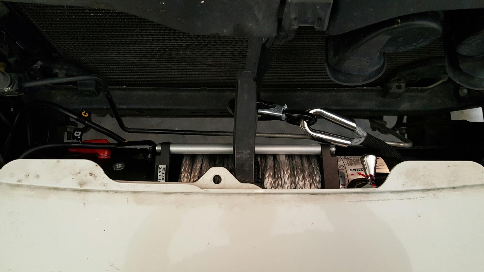

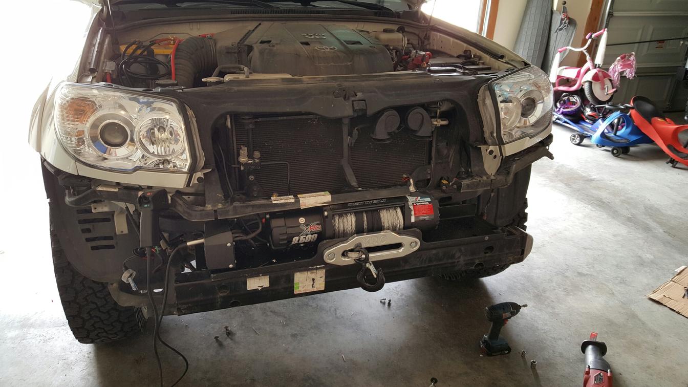

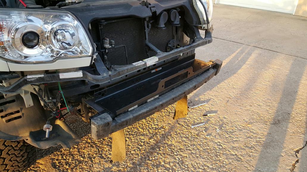

Hey everyone, did a decent amount of research and couldn't find much info. Was looking to add a winch to my 4runner, but dont plan on aftermarket bumper. Been in enough precarious situations by myself where this made since. Ok, on with details and pics.
Harbor Freight universal winch plate-$40
3/16s Angle steel 4 ft. plus 3/16s flat steel-$16
Friend with Welder and my imagination....
Smittybilt XRC 9500 with synthetic line (wanted to keep weight down)
Dont have the best pics but surprised i remembered this many lol.

Very nice and clean looking. I have a Shrockworks bumper and my sphincter is clenching knowing I'm going to have to either remove it or do some cutting to get a winch in there.

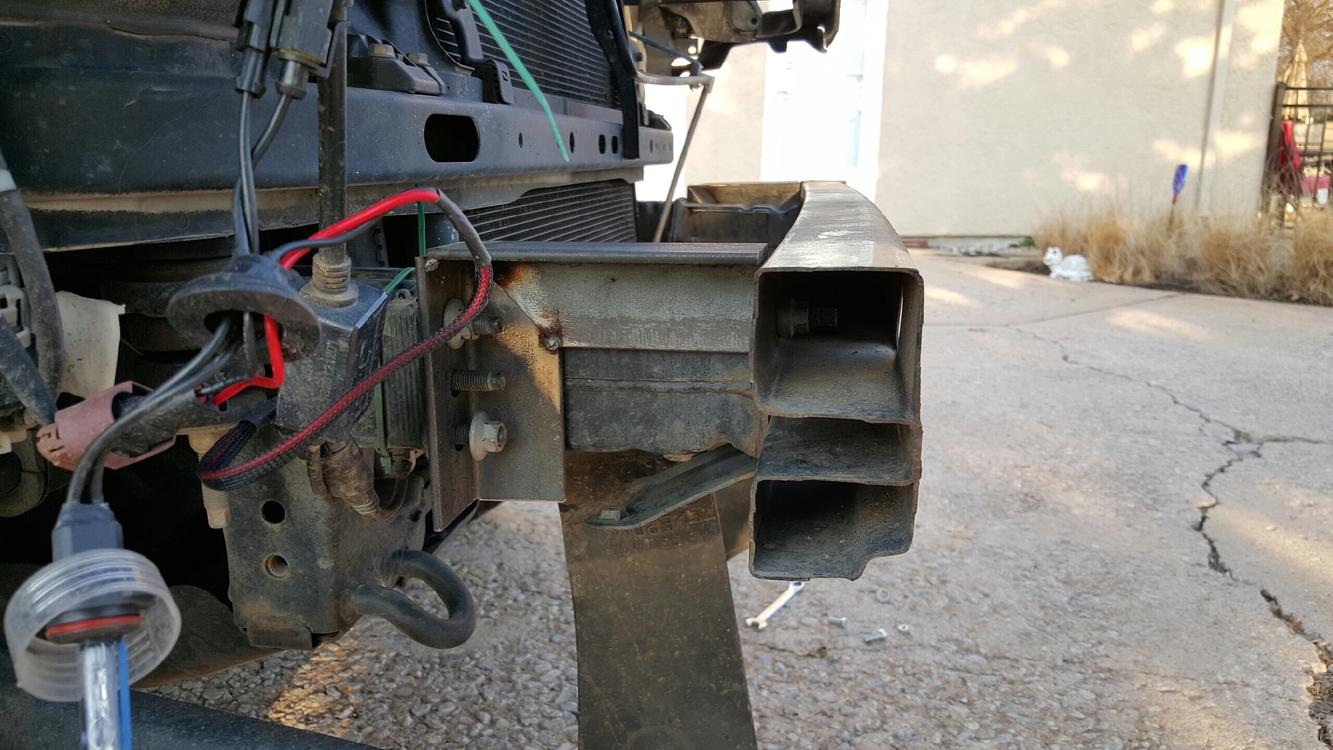

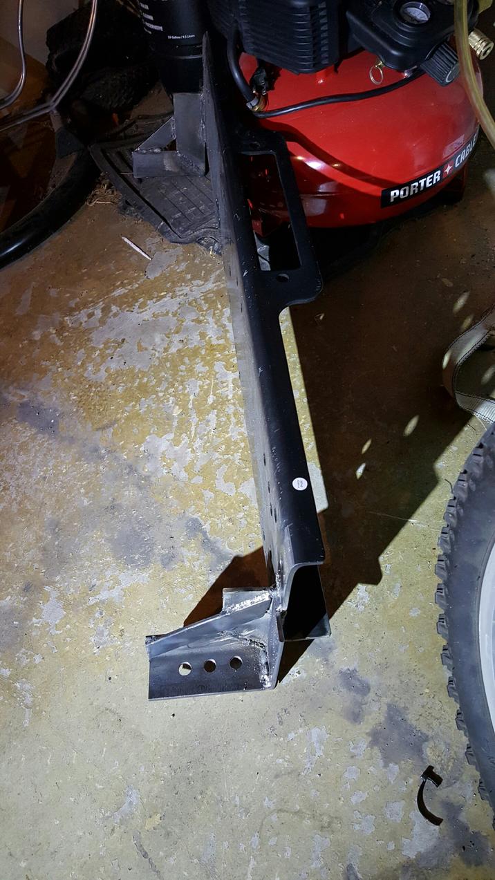

That is awesome, exactly what I am looking to do. Any chance you could snag some pics of where you welded it to the frame? or any specific cuts you had to make?
Thanks for the positive remarks. Attached another pic to maybe answer the attachment point. Basically mounted to the crossmember attachment to the frame. Here is a pic of figment early on. Then these brackets were welded to the harbor freight mount. So, if need be, this is not to difficult to remove.

This is very helpful!! I had looked at the Budbuilt hidden mount and was thinking I should be able to build something cheaper. Thanks for sharing!

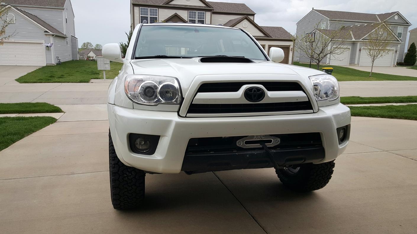

Wow. Finished work looks very nice, wasn't expecting it to be that nice when reading the first post. Great job though!

Just an update, I ordered a black failrlead, didn't like the chrome on the front. It comes in tomorrow and I will throw on and get to testing and report back. We are on the same page for the ideas.

Found time to test the setup tonight. Started light and progressed with more and more brake pressure. also put a 10 inch tall log in front of the wheels. It handled all of this extremely easy. After i built some confidence up i pretty much laid on the brakes and it drug me through the grass. It was really bogging the winch down pretty good which was the point. Mount held up great with no bad sounds or damage. This is not an extremely conclusive test, but for what I hope when I need I am satisfied.
