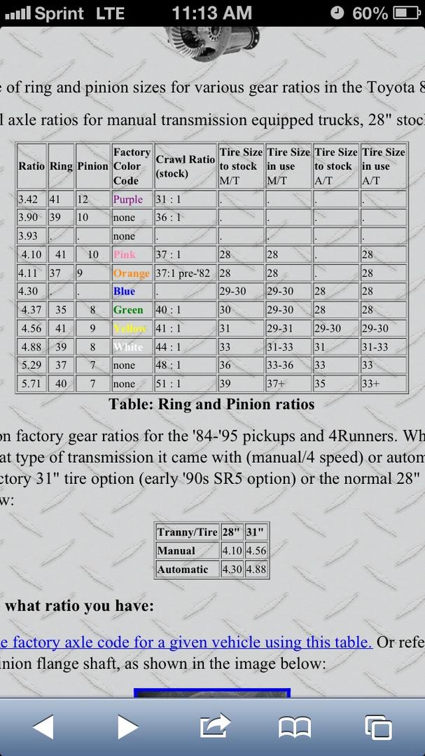

Two suggestions one try to use some paint thiner and clean the decal. Two take the front diff cover off and do a ring and pinion count. This is a chart that will tell you gear ratio
