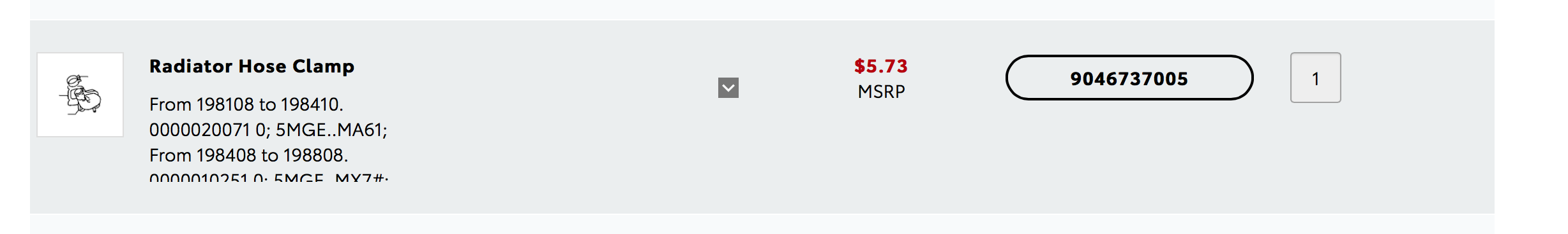

From Toyota parts online

When I type in the part number noted above from Carlos V, 90467-37005, it says it won't fit 97 4runner. How different could these clamps be from year to year? Also, on the diagram they sent me from Camelback a while ago it lists a different part number for the clamps on upper hose versus lower hose. That also makes no sense to me. I had found a part number earlier of 90080-46352 which the CB website also says won't fit my 97 4runner. Maybe any of them would work, who knows?
So I just talked to Olathe Toyota parts guy and he quoted me P/N 90467-37005 which is the same as Yotashop, so maybe thats the "most correct" radiator hose clamps. Probably way overthinking this...
I replied to your other post that the 90467-37005 is the correct PN. I have them on my '97.
Thank you! I fail to understand why Camelback, using my VIN number, says those "won't fit".

I found that 90467-37005 ($7.21 at Olathe) is shown as replacement for 37001, 37002, 37004 and 37006, while 37003 ($8.87 at Olathe) is also a replacement for 37001. The 37005 part shows years 2000-2014 and the warning "This part does not fit your 1997 4Runner", while the 37003 part does not list any applicable years and does not show a warning. Obviously it is a data issue not a fit issue since both 37005 and 37003 'replace' 37001.
