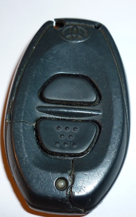

I’ve been looking everywhere for a new plastic housing to replace my factory remotes. I even looked on eBay for non-working remotes with good plastic without luck. All three of my factory remotes are old and in various stages of decay. I finally had to buy some of these pouches to hold the remotes but I really never liked the look.

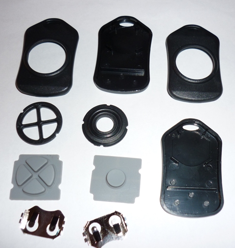

After some trial and error, I finally found a remote housing that, with minimal modification, would fit the Toyota innards and work
Parts list
Bit of heat shrink tubing (5/32”) or electrical tape
FB20 4 button remote from polycase.com $2.55
Battery Holder $0.45
Tool list
Needle nose plyers
Diagonal cutters
Utility knife
Hot Glue Gun (or slow way clear silicone)
Soldering iron
You'll note I ordered both single button and 4 button remotes (hoping to get lucky with the single button). The housing is identical. You might be able to modify the button ring on the two button remotes to work as well but as they come, they wouldn't work.

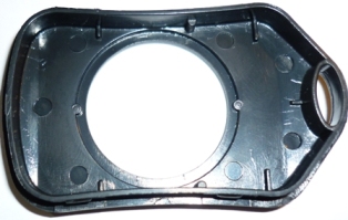

Trim the back piece
Start by trimming all the raised plastic in the back piece with the diagonal cutters and knife. It should be flush.

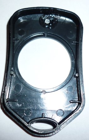

Optional - Drill a small hole in the face piece in the mold mark to allow the LED to shine out. I used a #43 wire bit. The mark is the circle in the center of the housing opposite the key-chain hole.

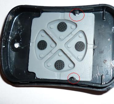

mount buttons
Mount the buttons on the front plate. Trim the two mount guides (circled in red) for the gray buttons to about flush with the top of the vinyl (about ½ way down).
Fire up the hot glue gun and soldering iron

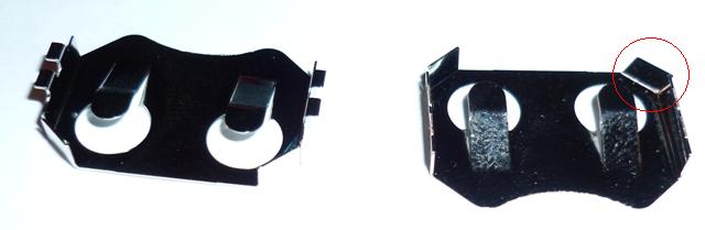

Battery Holder
Trim the battery holder. Cut off the PCB mounts and bend the upper right tab flat.
Original left and after right. Note sure why I took the picture with one upside down but too late. I circled the tab that needs to be bent flat.

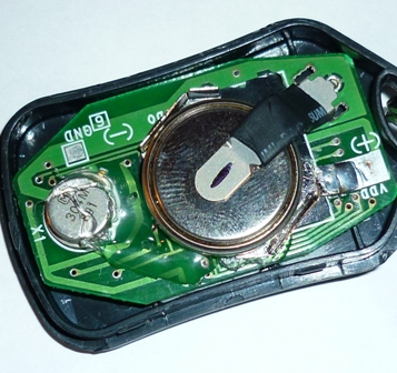

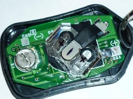

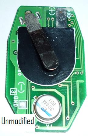

mount the battery holder
File the plating off the battery tab top and bottom and solder to the positive terminal on the PCB.

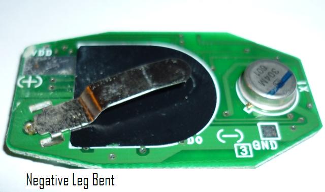

Bend the leg for the negative lead so it can get over the edge of the battery. Put heat shrink tubing on it to prevent it from touching the positive edge of the battery.
Hot glue the battery holder in place, and put a layer of glue along the bottom to keep the battery from sliding out of the holder with a hard jolt (don’t think it actually would given how tight it is when the cover is on but just in case).
Use the hot glue to seal the hole you drilled for the LED. Do it from the inside and put an ice cube on the outside to keep the glue from over penetrating.

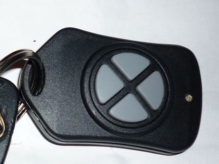

There are before and after pictures. I'm not sure what battery the factory remote is supposed to use but CR2032 is too big for the housing. CR2025 works but it is tight (that's what I ended up using), CR2016 would probably snap together easier but with a shorter battery life.
Yep, two more buttons for a total of three that don't do anything. It must be an upgrade. All said and done when I did my second remote, it took about 20 minutes.
