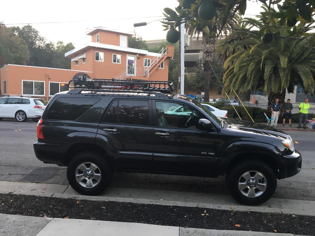

my basket

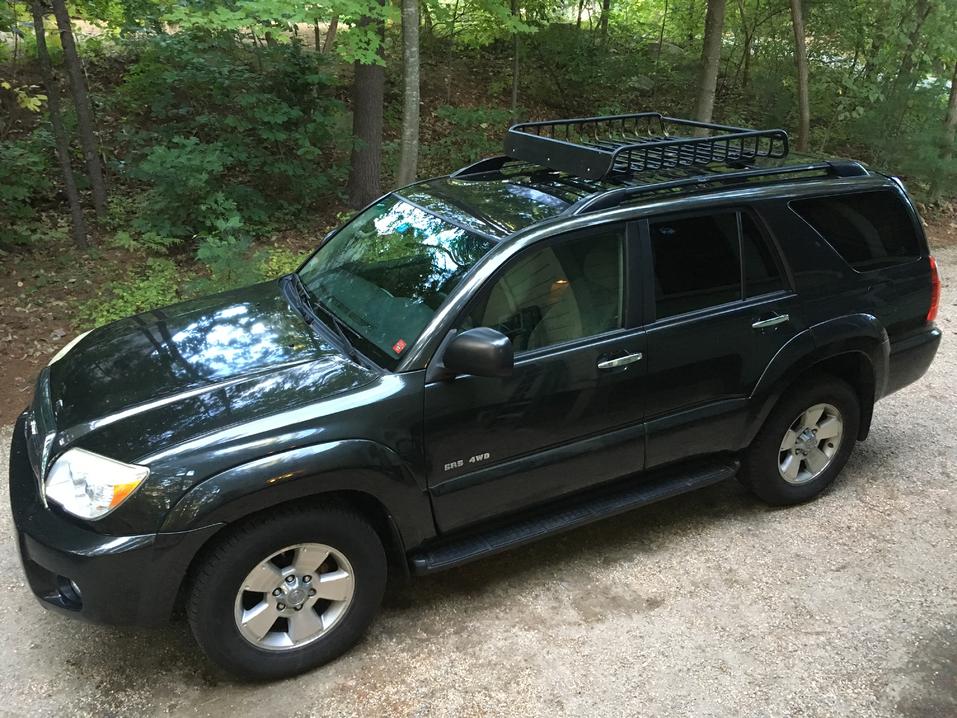

my basket
Personally, I would not be as concerned with a basket that size. As you can see the megawarrior with extension basically covers the entire roof. So obviously it was very disturbing when I saw it was working it's way off the rails.

nearly twins! i've considered removing my running boards but i actually use them to reach the rooftop.
Shadow mica baby! I pulled off my running boards within a month of buying it. You cant see it because of the lighting, but I replaced them with rock rails from rocky road outfitters. Not bad for the price, they saved me one time, but I wish I dished out extra for the rails with kickers.
