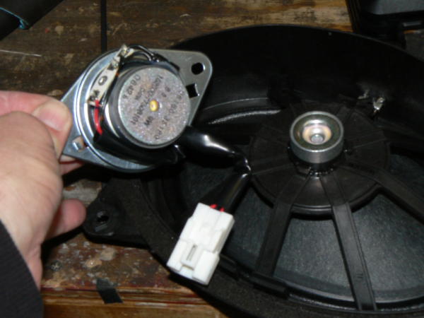

'07 Crossovers
There are no "crossovers", there are chokes. I just replaced my '07 stock speakers with Polks and I know what I pulled out.
Also, you don't have 6.5" seperates, you have 5 x 8 seperates.
The tweeter has a single "bass blocker on it.
As a matter of interest, the tweeter also has a bigger magnet than the 5 x 8 mid, wierd.
