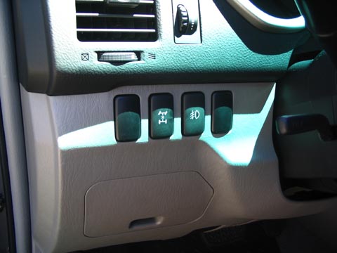

I used the 05 Taco switch for my Hellas...

MW 4Runner said:
That looks great!!! Where did you buy it, the dealer?? If so do you have the part number and how much was it?
yea, dealer parts
84160-04010-switch ($40)
90980-11090-is the harness that clips to the switch that will hold the wire plugs ($5)
82998-12340-wire plugs ($4.95 each)
not cheap to do, but gets the best results IMO
you can get more info here
its a long read, but it will make sense
you can also check here for more info

Thanks. Your install looks great in that thread. I'm assuming those are Hella 500 FOGS and not driving lights. Im fixing to get that exact setup you have (bar/lights).
MW 4Runner said:
Can you use them without getting flashed by on coming drivers? How well do they light up the road ahead?
sure, I use em all the time...aiming is key...just be sure they are not aimed higher than the factory beam...they light up the road very nicely.
