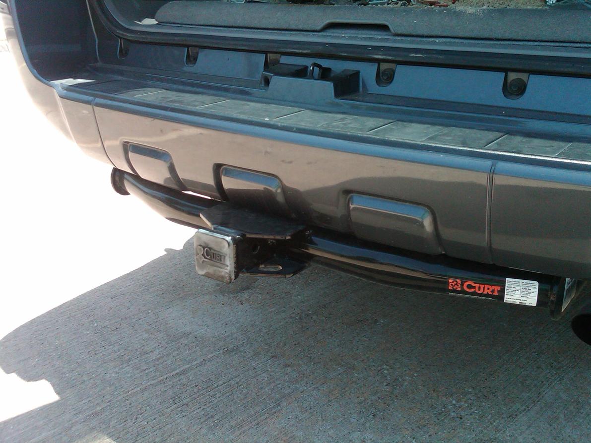

FWIW, I just installed the curt 13345 last week on my 07 sport. The factory wiring plug is up under/ behind the hitch {hard to access but can be relocated or used as is}. The tailpipe can be pulled to the side by a friend and allow the passenger side bolts to go in easy. I removed the factory tow loop with an impact gun and installed the curt hitch by hand with a torque wrench. Me, friend, air tools = 20 min install.

Nope, the factory harness stays where it is. You can still reach it with the hitch in place. It's mounts far enough back that it doesn't cover the wiring harness. The downside (if you want to call it that) is that it sticks out a little further than the stock hitch.

jimithing, I didnt get the curt hitch hole cover with mine. Was I supposed to? or was yours optional? Also its very easy to remove that ugly orange sticker. I reloacated mine to the rear of the tube so its still there, just not visible.
