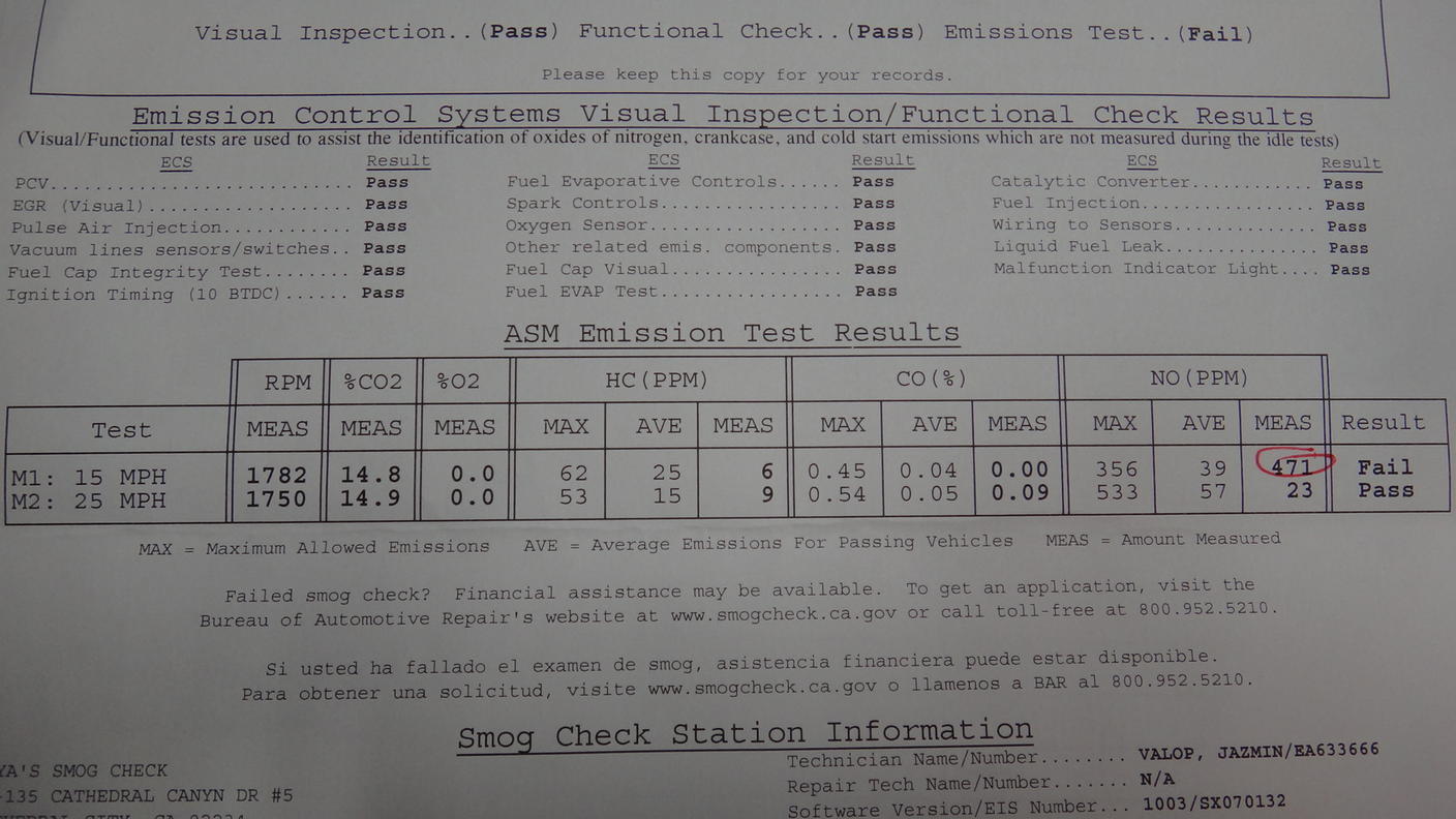

Went for my 2nd smog test today... and failed :( Again for the same thing... "NO" levels are too high (the max allowed is 356. The first time it was @750, but had dropped to about 450 this time). They did say that it's definitely not the cat as CO2 levels are almost zero, so that the cat is doing it's job. They said they feel it's some issue in the EGR system. In addition to all this, my check engine light came on later in the evening. I stuck a paperclip in the under-hood diagnostic connector and got the following code. Can someone please confirm what it reads:

1) After 1st smog test: The technician said that there's a "lean condition", and it could be any of the following: EGR system (he said it's most likely this), incorrect timing (at the time this couldn't be checked as my lower timing cover was not there), or finally the cat. I had passed "HC" & "CO" with flying colors, but "NO" was 709 (max allowed is 356). I started by installing a lower timing cover, having the timing set to exactly 10*BTDC.
2) 2nd smog test: "NO" reading was 471, so failed again. This time the technician said that if I go to a repair center and they say the cat needs to be replaced, that means they're trying to rip me off, as the measured "O2" levels were zero, and the cat is doing it's job just fine.
3) Went to a friends garage, his Dad took a look, checked the EGR with a vacuum meter and checked EGR vacuum modulator and said that it's working fine. He then said that the timing was way off (even though I had someone else set it previously at 10*BTDC, and the truck was running excellent with good power). He said he's resetting the timing (re****ing it) so that it will pass smog, and that he will readjust it after the test. I use 87 octane gas, so he said to run it till the tank is empty, and then top it up with 91 octane and then go for the test. Do you guys think I should try this out, as I'm thinking that all he's doing is fooling the smog test, while there's something still wrong with the truck. The other thing is, the way he has set it now, it doesn't run well at all (like there's a constant miss at idle), and no power during acceleration.

Here's a picture of the 2nd smog test in case it makes more sense to some of you to pin-point the problem:
