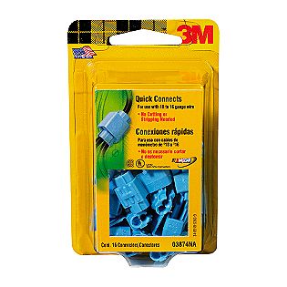

Connect the 2 wires leading to the bulb socket with one of these...
Do not reinstall the bulb, but insulate that socket somehow to reduce the possibility of a short. Electrical tape will work fine.

Ok cool, thanks. So by clamping one of those on before the socket, it is kind of an alternate (shortcut) route for the electricity to travel before it reaches the socket? So it can travel through the wires, and not need a bulb in the socket right? I know Im making this way more complicated than it should be lol, im just horrible with electricity.
Im gonna go pick up a pack right now, hopefully it works. Thanks
Don't take this too hard, but that is the worst advice ever. "Scotch locks" are universally known to be terrible for making a good electrical connection. At worst, I've seen them not even pierce the wire shielding and never make a connection at all. At best you end up a cheap piece of metal that doesn't conduct as well as the wire itself does. If they do work, they often fail over time be loosening or breaking the wire strand itself.
So I went to an auto parts store and got a pack of those clamp on wire connector things. I tried it a few different times and it was a no go. The fogs wouldnt turn on, and instead it would just turn on the high beams. Thank you anyways for the advice.
