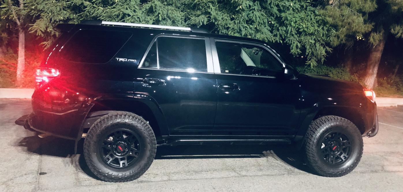

Anyway, I have a 2018 Pro with 285/70-17 Falken AT3W's on my factory Pro wheels. I have Cornfed spacers, 1.5" front and 1" rear. My center of hub to top of fender arch is 22.5" front and 23.25" rear. No rubbing on anything. No mods besides the spacers. The Pro comes with the fender liner cut from the port. That makes a difference, along with the Pro wheel offset. Go 285's as you have many more tire choices and availability then 275's. Unless you are a hard core rock crusher I would stay to a C or SL load. Good luck.

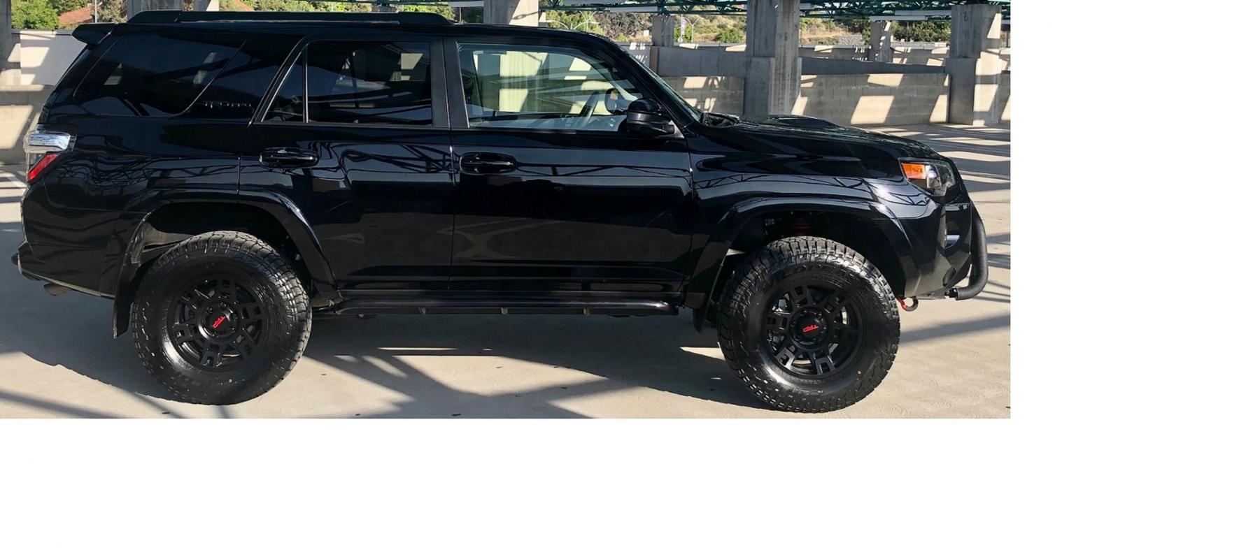

I have a 19 pro with eibach front springs on the fox and a 1/4” strut mount shim, and SPCs. I have 285 KO2 on stock wheels and have zero rub with mudflaps on.

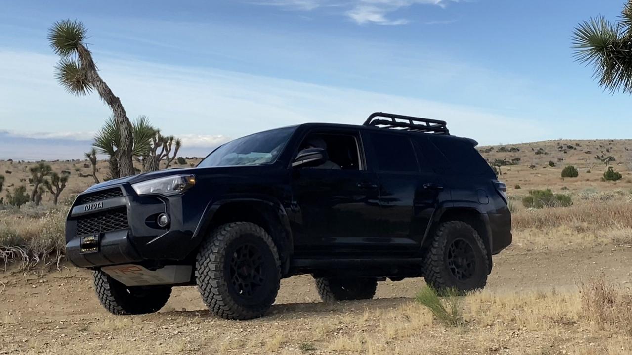

I have 2020 Pro.
I installed Eibach 1.6" springs, with 2 Ekstrom Designs shims up front. Total roughly 2.5 inch lift. Rear has load leveling system by Eibach, set nearly at max height - I assume 3 inches (+,-)
JBA High Caster UCA - set to -4.3* caster on both sides
Wheels are SCS Ray 10, -12 offset 17x8.5. Tires 285/70/17 Toyo At3.
I rubbed the body mount hard at full lock in reverse.
Decided to have Stellar Built do a body mount relocation, and pinch weld, instead of body mount chop (cab mount chop). Very purdy welds. Reason I went full relocation, will probably go bigger once these tires are done. Love them so far, very quiet. Would most likely go 285/75/17, possibly re-gear at the same time.

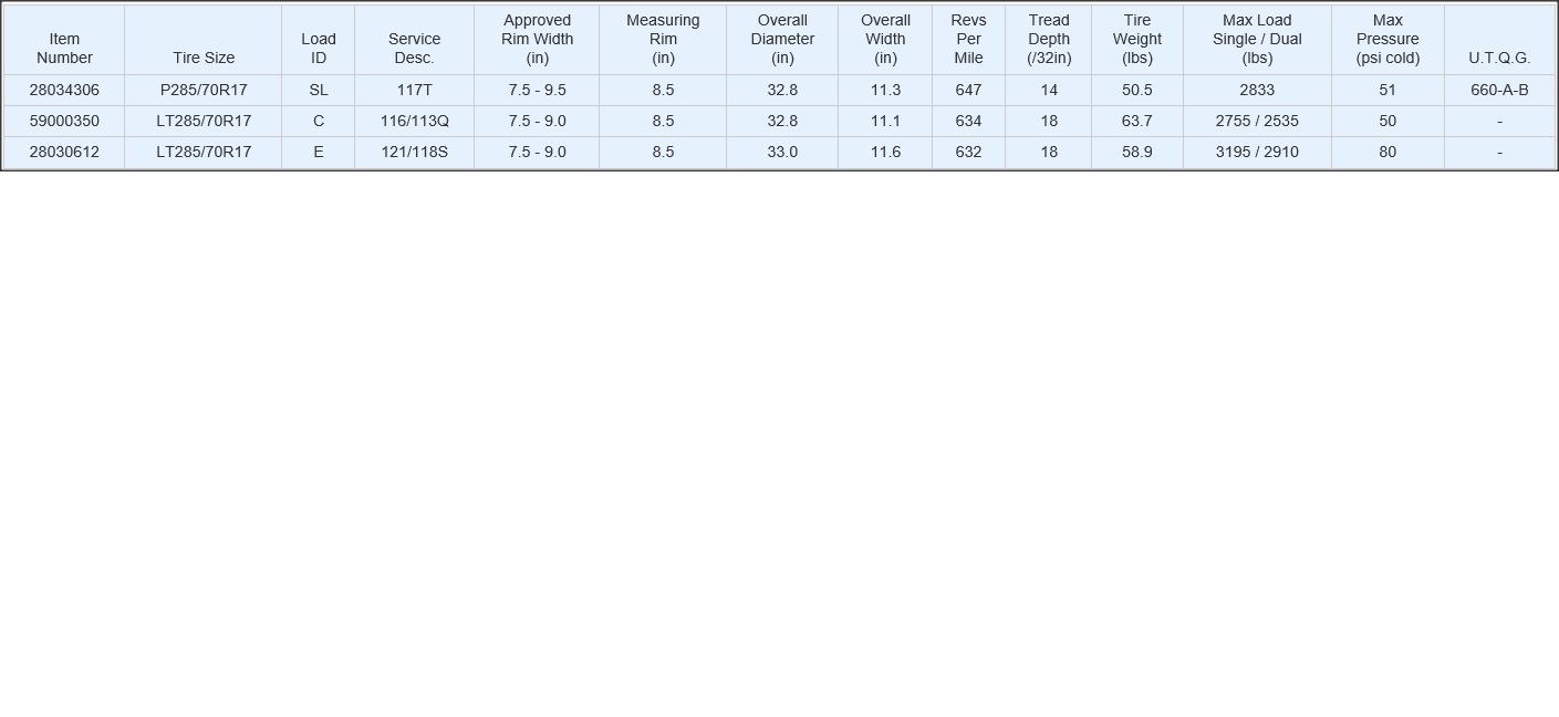

Slightly parallel question:
What load rating are you guys running?
Sorry if this question is asked before..
I see 3 different ones available in the 285/70/17.
Iw1LJh9
The C load seems to be heavier than the E load and doesnt support as much weight. Why would I want to choose the C load at all? Is the ride comfort worse in E load?
Ofcourse, the E load is about ~$30 more than the C load but I on the long run over 2-3 years, this is a wash.

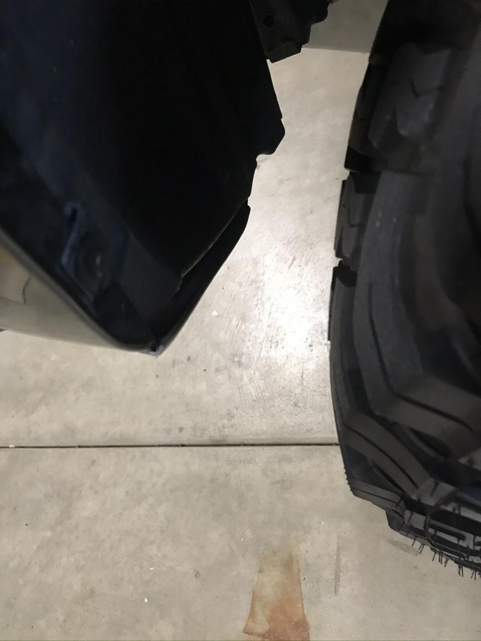

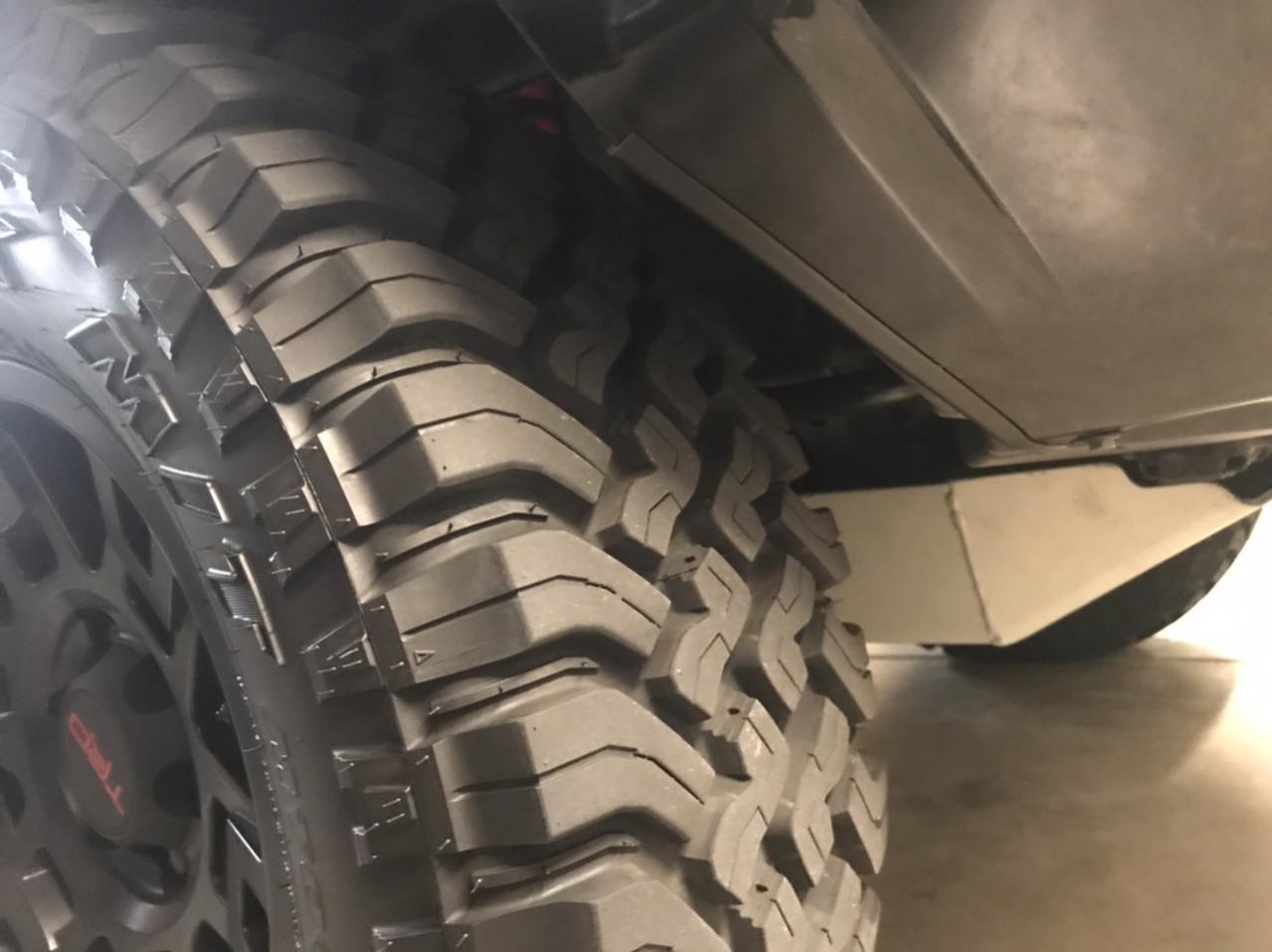

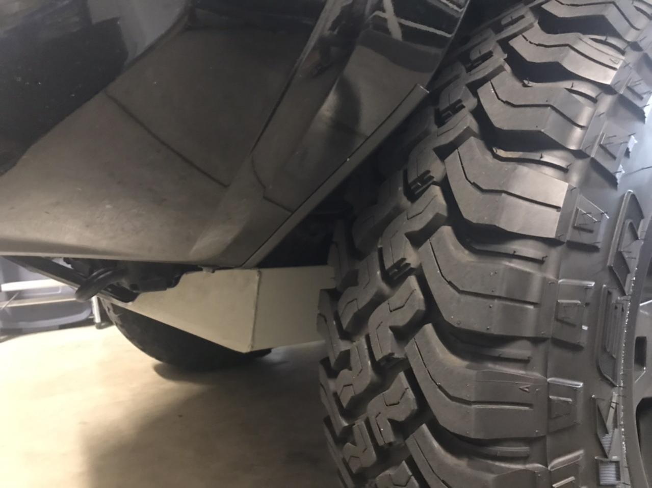

My set up
2015 TRD PRO on OEM TRD Bilstein suspension with Cornfed 2/1.5 spacers
Tires: 285/70/17 Falken Wildpeak MT’s wrapped around the OEM SEMA wheels.
No BMC, no mud flap removal, no rubbing full lock in reverse after just minor fender trimming and fender liner forward adjustment.
