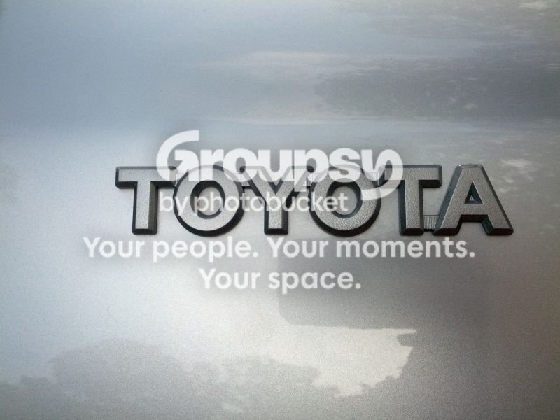

I am sure there is a lot of videos on the internet explaining proper techniques for plastidipping. My question/concern is how people get the interior of the letters out without pulling the plastidip of the letters themselves. I am talking about the toyota/sport edition/limited style letters on the doors and rear hatch.
Its much much much much easier than your mind makes it out to be. You literally just tape off the area, spray 3-5 coats to completely cover the entire area, and peel away the portions that you dont want to have covered up. The tiny gaps between the badges and the body panels leave a space where the layers of dip do not connect to one another, and if they do it's thin enough so that it tears easily and neatly along that separation. A small tool (I used a dental pick and a steady hand) helps to pick at and peel away the dip from insides of letters. Watch the you tube videos. Don't be afraid to experiment with this stuff. Mistakes are EXTREMELY easy to fix. Just peel and start over.

a tooth pick works well at getting in between the letters. just pick at it until you make a hole then twist and it wraps around the tooth pick and comes right off

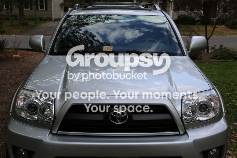

I blacked out my "chrome" grille on my navy blue runner. . what do you guys think, should I take off the plastidip on the emblem and leave the rest of it blacked out. . or just keep it all black?
take it off the emblem
I left mine all black. Could go either way I guess. If you dont like it, just spray over it again.
