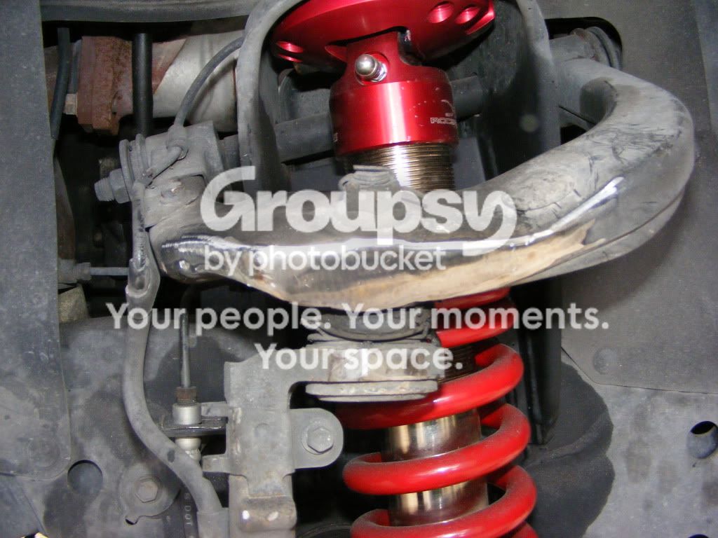

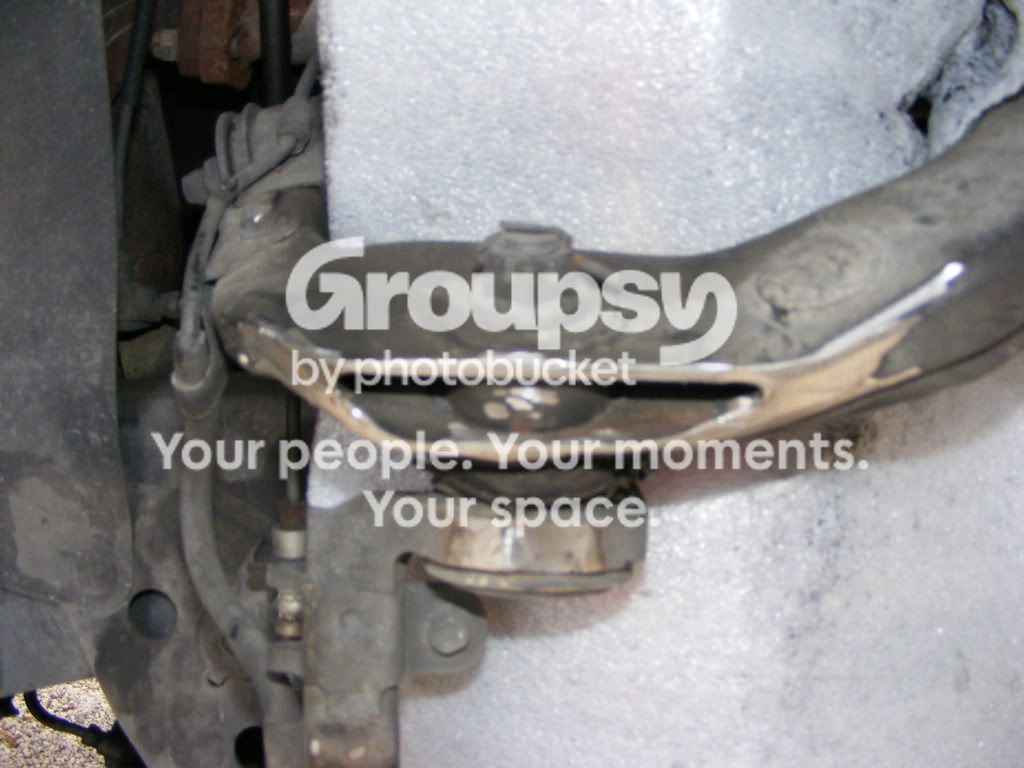

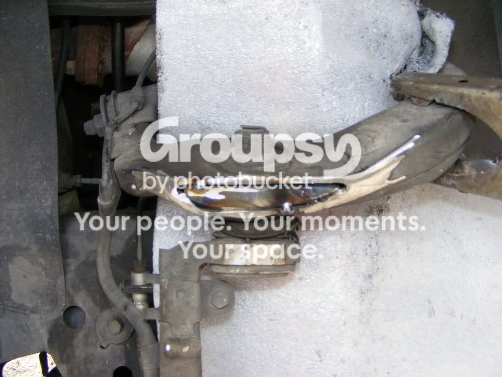

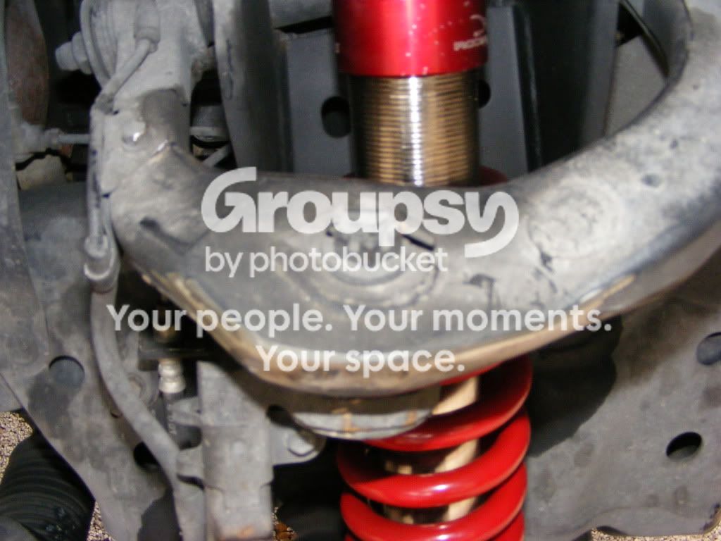

If its not actually bent you could always just clearance the stock uca's, thats what i did so i could run my 285's w/o buying spacers and without spending a bunch of coin on aftermarket ucas, heres some pics. Havent had any issues with them so far and i got a good 1/2" more clearance between the tire and uca then i did have before.
This is a before pic, but after i had already grinded on it some the first day so i could drive it.
DSCF6172-3.jpg~original
This is after i cut the section out
DSCF6174-3.jpg~original
This is the filler plate tacked into place
DSCF6175-3.jpg~original
And this is the finished product
