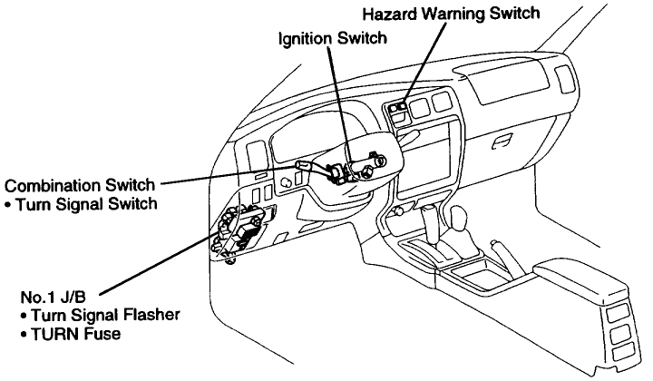

I just bought one of these because I was going to switch over to LEDs. Where is the damned thing located? I have the interior torn apart right now to do some electrical work, and I assumed it was behind the kick panel on the driver's side, but I didn't see it anywhere. I was going to search, but since this was at the top of the page I figured I would just be lazy and ask! :flipoff:

The LED type are much brighter than the halogens and will drop right into the same grommet and have the same type of plug. So that's what I'd do if I were you. And the Tridon flasher will solve the fast blinking problem, you just have to unbolt the fuse block that's behind the dash panel and the flasher is on top of it.
I did a write up on it a while back. Not hard at all Here's the link. I have to go in there again because I went LED with the new bumper.
http://www.toyota-4runner.org/3rd-gen-t4rs/104161-what-did-you-do-your-3rd-gen-today-728.html
I didn't have to unbolt the panel. I just laid on my back with my head against the pedals. I left the hazards on so I could feel which relay it was and was able to take out the old and pop in the new.
