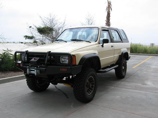

Got pics of your truck?
I'm hoping i can find something compatible with this

So like this?
Check ARBs website.
And for your nerf bars, they dont provide much protection. Might want to look into a set of rock sliders.
I was hoping for one abit more like the one above. But not completely covering the quarter panel. Perhaps auctually looking allot like the fender flares
Before you go too far on other parts, you might want to heed what Hyde suggested--those nerf bars aren't going to cut it if protection is what you really want. Find some genuine rock sliders, with multiple attachment points to the frame--what you have is more of a show bar.
I am looking for as much protection as possible. Those nerf bars in my opinion protrude enough, but i've not been able to find that quarter panel bar anywhere... perhaps it's custom. I really would like to out fit my 4runner with complete protection though.
On the nerf bars, it's not how far they protrude, it's how much weight and abuse can they handle. You drop onto those too often, and they'll be bending upward, or snap off altogether. Look at the bars from, say, AllProOffroad, and see how many support bars they have in the middle, plus the gussets on said bars at the frame. If you're serious about protection, that's the route to take (don't want to flop down on a rock and suddenly not be able to open your door because your nerf bar's in the way!).
