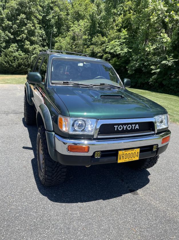

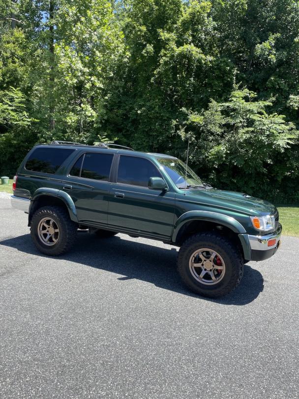

This is the only difference. I have a '99 with a '98 bumper and lower valence. It's not a limited so there aren't any flares but I can post a few pictures if you still want.
I did this swap on my 01
IIRC the bumper brackets that attach to the frame are not interchangeable between the generations of bumper, just FYI. I can try and find a part # if needed, but you'll just need to get the earlier generation brackets if you intend to do it.
Attached a few photos

Thanks - sorry for the delay in reply.
Yeah I just dug through all my orders emails, and I purchased a chrome plated limited bumper and valance from ebay, something like this:
https://www.ebay.com/itm/126457856454?fits=Submodel%3ALimited%7CModel%3A4Runner%7CMake%3AToyota&_skw=96-98+toyota+4runner+limited+bumper+valance+chrome&itmmeta=01KAXPJ0W7ME6SVSJ74JCS0V6R&hash=item1d7179c1c6:g:Z~EAAOSwZctmML62&itmprp=enc%3AAQAKAAABEFkggFvd1GGDu0w3yXCmi1eFw%2BfdF3r%2BgpkC7ogScaMuYVRN8bBOCvX3PHSR8ZF5214Om9jCVkutDSkenKduoVc%2Ba5F1WM1m6QXDh6h2sDQ%2BxsIReRWhHAKUoYd30CFJuC2Nc%2BIvPKeTiuOA%2FmDuOHWgNJR%2B%2B%2BtxHySVFS7ftwVD%2F8Y6an5H67vJ4v4lEmFKUTJiinL77ayF2gwRO1SMgSrN7zTdQyJ%2FdV0jjwxr7ESFvnDgDy06Eumo%2F2khIQvXn0fUcGLgvCMwuv3ncX0tLHPpIc1pd66CHD266fyWLRtk5aNypyVIhu%2BURPc5BKAWfjA9WndSeIBrZMbbrwle%2FsRmrUAlQphZR57hA7NAOT%2Bh%7Ctkp%3ABk9SR7qOyLbXZg
Then I got on the phone with a local dealership to oder these:
52142-35050 1 $ 39.00 Bumper Face Bar Bracket (Left, Front)
52141-35050 1 $ 39.00 Bumper Face Bar Bracket (Right, Front)
I try to go with an OEM+ type of look so, I say this because you'll also need the turn signal lenses - amber being the OE, but they are different than the fat lip bumper. Some bumper kits may even include the lenses with them, just FWIW.
Good luck
tried editing my last post multiple times but I can't seem to get it to submit... so apologies for the 2x post, but I forgot to say you will want to save all the clips that the lower valence uses on the fat lip bumper to xfer them to the new (old?) one.
IIRC you'll also want to soak them in a rust buster for a day or two before you go to town if they're rusted a bit (ask me how I know...)
cheers.
