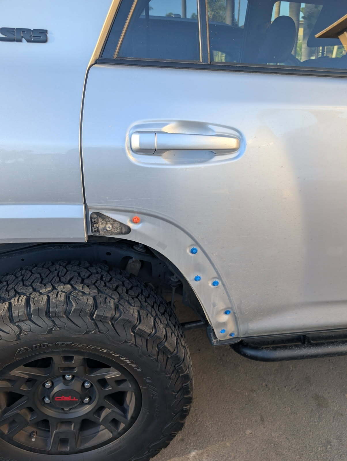

Finally came off.
Looks like a combination of clips failing in the body and what they attach to in the fender.

All those clips, the blue and the orange ones, are supposed to stay on the trim/fender flair, not on the body. Since yours stayed on the body, there is definitely something wrong with the trim.
I bought these cheap replacements when I broke a couple last year.
Amazon.com
I don’t know how they’re supposed to stay on the plastic trim when the blue ones require a 90° twist to insert on the body.
