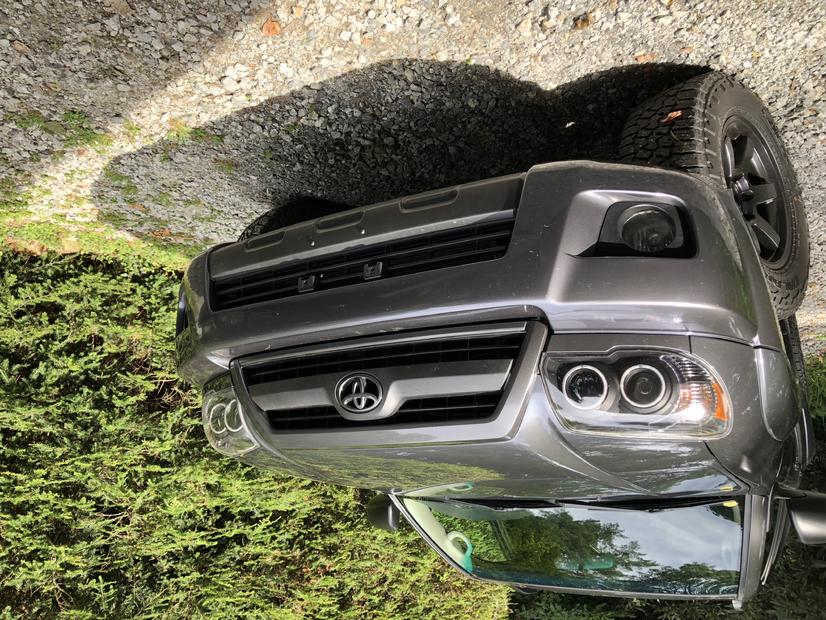

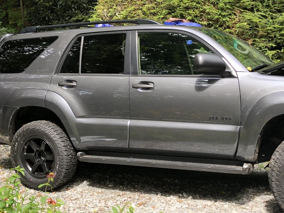

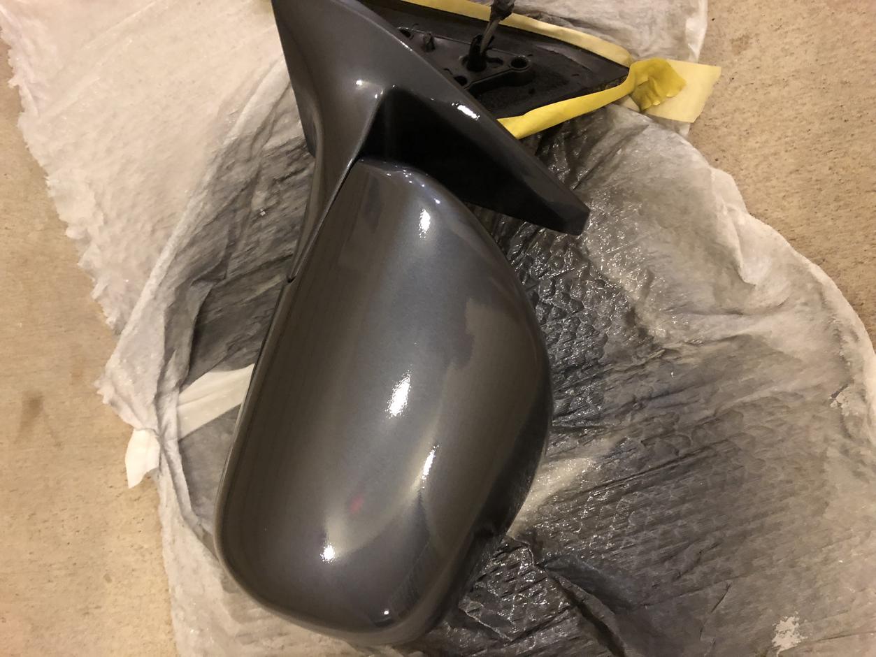

Oh okay yeah that’ll need a repaint. In all honesty the paint and clear I used were easy to use and would save you a lot of money from a actual paint shop. Plastidip would be cheaper though. Here are some of the paintwork pics to give you an idea. (Btw sorry for the upside down pic)

I like how that turned out. What paint did you use and how did you get the colors to match?
I have a silver SR5 and would the grill to match the body.
Thanks! and its from ERA paints. Heres a link to the paint for your car.
https://www.amazon.com/ERA-Paints-A...37936358&sr=8-5&keywords=1d4+spray+paint&th=1
You will also need this for the top coat
https://www.amazon.com/SprayMax-Gla...qid=1537936459&sr=8-2&keywords=2k+spray+paint
Make sure when you do it that you prep the grill properly. I sanded first with 600 grit (followed by a clean down with isopropyl alcohol) then did a light spray of primer to help with bonding.
