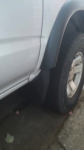

You can still get the base front mud guards (with hardware) from Toyota. I put a pair on last week after finally ditching my banged-up running boards. They don't look that great with the SR5 flare, but do fit nicely in the mounting location with no drilling. I drive on gravel a lot, so I figure they're better than nothing. The part numbers are 76621-39395 and 76622-39395.

Yeah, Toyota says they fit the 2002 also. I think they might even line up nicely with the skinny chrome, no promises though. :)
