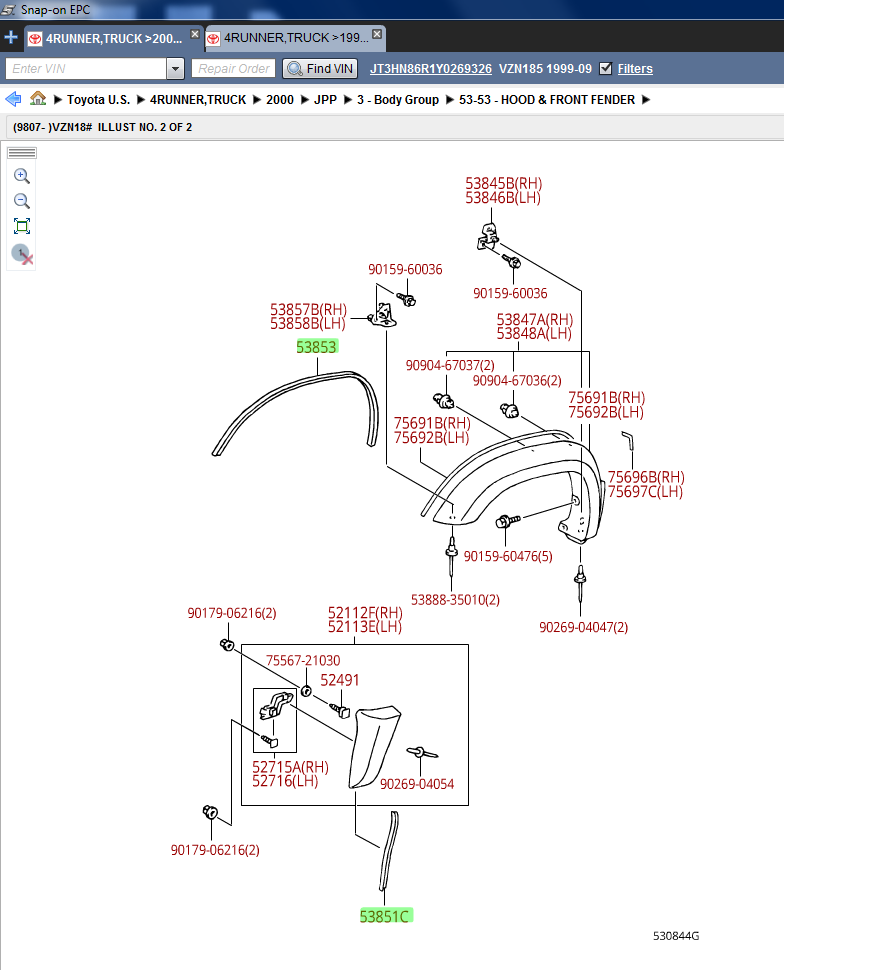

Well, I called the dealer and gave my VIN to check for the parts, but the dealership told me that my vehicle didn't come with flares. This would be inaccurate, as every body panel on my 4Runner came from the factory tagged with the VIN number and they all match.
Anyone have a part number for this stuff? The one I found closest for the front was 75691B for the front left fender flare. Anyone have something else?

Just tell them you have a 2001 Sport or something, as all of them had flares/weather stripping.
Edit: I think this is the part numbers, "Flare Pad". It has all the colors too.
https://parts.olathetoyota.com/part...ER&subgroup=EXTERIOR TRIM&component=Flare pad

send me your vin i will look it up for you
look at the picture below. your flares look like these right? also you dont have the thin strip you have the larger ones in the back highlighted in green they come "painted" a dark grey which you could easily make the same black to match your truck 202 is your paint code on the truck. I am working on the back as soon as you let me know this is the fenders you have

Interface. We haven't updated yet and your screencap looks waaay diferent.
yeahh we had the new style for about a year now. we were running the old program on vista. when microsoft cut support for it we had to upgrade because the new interface wouldn't run on our old computers. I called the PRA yesterday and they said support was ending soon on the old snap-on catalog. you guys will hopefully upgrade soon. i like the new one way better
