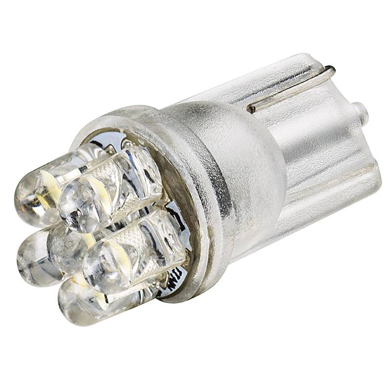

The shifter takes a single 194 bulb that you can access by prying the shifter bezel up
Mine was dead so I installed this one and it's hella bright
https://www.superbrightleds.com/mor...b-6-led-miniature-wedge-retrofit-car/200/881/

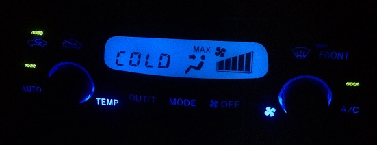

Well I got my #1 fixed. It wasn't any issues with the grounds it was a issue with the hardware. I sent it to a guy on ebay and he fixed it for $60 and changed the LEDs to blue as well which I couldn't be more happy cause it's matching some of the mods I'm doing. Next is my radio I'm replacing it with a Kenwood DDX374BT which will be here sometime this week and I'll put it in the next week on my days off. Here's a pic of the AC unit after he changed the LEDs.
It's a daylight picture I'll take another and update it tonight.
Night Pic:
Night Pic:
Your welcome!
PS That a horrible picture of the way it really looks. This one's a little better :biggrin1:
