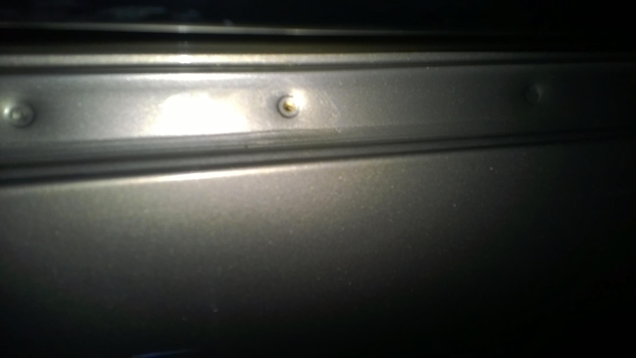

Mine is missing them as well. On the one side, a few of those "spot welds" actually started rotting out. I'm assuming from water sitting? Food for thought.

I was referring to the dimples in that channel. It looks like they're spot welds of some sort. I can't say if exposure to more moisture started it, but I had pinholes forming in a few of them. Here's a picture of it. Can't say for sure that these missing had an effect
I know you were...that's why I had quoted philskeeter :)
I wouldn't suspect there's a direct correlation to removing those channels and those spots rusting. The channels help shed water. They aren't completely sealing off the channels.
