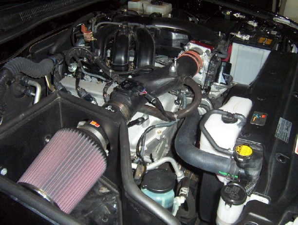

If you replace the intake with a CAI of your choice then you will remove the "Charcoal" filter anyway.
Here ya go!!!
