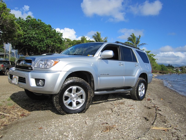

Skip the FJ stuff and just get a set of coilovers for the front. I'm running ICON- they are AWESOME. The ride on the road is awesome. They soak up everything, I can accelerate over speed bumps, the truck handles BETTER even though it's higher. And they are adjustable. You can leave the rear stock and use the coil overs to level out the truck. Or go with Icon's 2" rear springs and run the fronts as they come (3 inch lift). I'm doing that and running 265's, but looking to go for 285's next. Ditching the XREAS was a great move for me.
IMG_2155.jpg~original
DSC00366_2.jpg~original
Compared to a stock truck
IMG_0045-2.jpg~original
