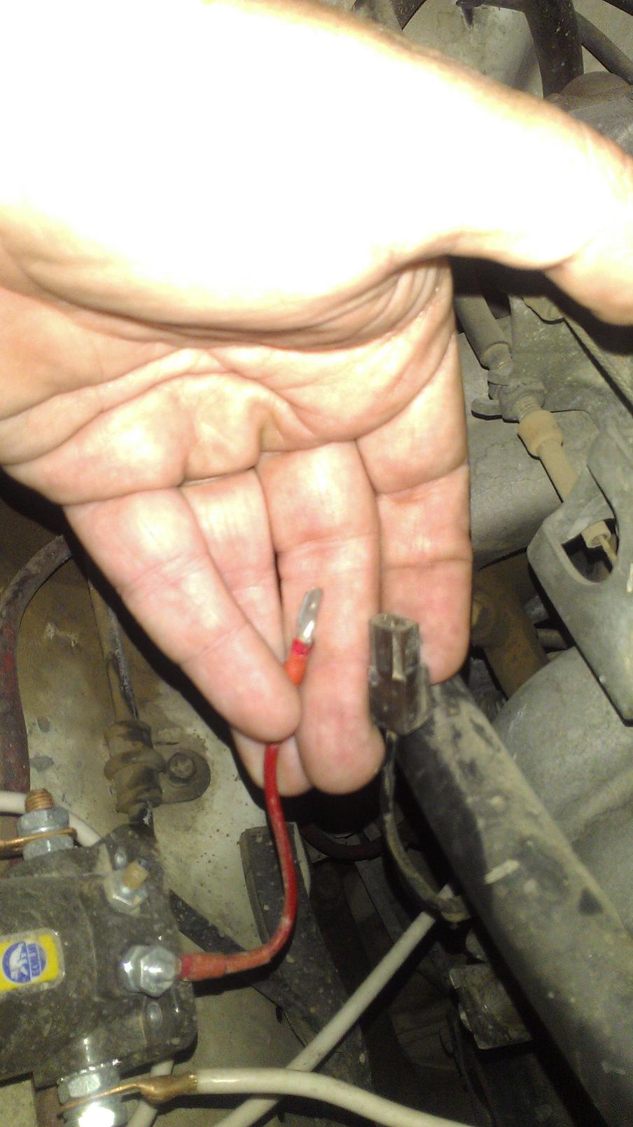

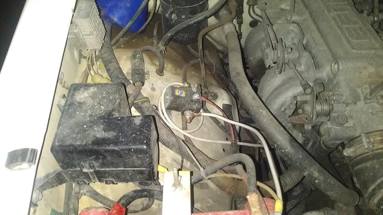

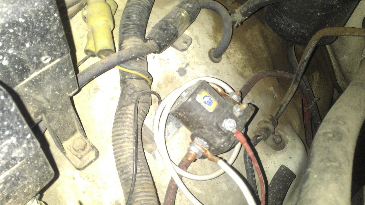

The last thing I did was install a new voltage wire from the battery to the starter and put an aftermarket relay on the new wire, operated by the crank wire that used to go straight to the starter. It's been a year since I did this and I haven't had a lick of trouble since, so I think I'm safe to declare victory and post this little walkthrough. Massive credit to 4crawler and his site for the trouble isolation procedures and the inspiration to use a "hotshot", and more credit to the guys on my local board who helped me figure out the wiring to build it myself instead of dropping bucks on a setup from Painless Wiring.
What you'll need to wire your setup like I did mine: a 30 amp relay (I used an automotive relay, have the counter guys at NAPA give you a starter relay from a '78 Bronco), some 8ga wire with fuel/oil resistant insulation and 3 8ga ring terminals, some 14ga wire with fuel/oil resistant insulation and spade terminals, dielectric grease, heat shrink, and the starter connector on a crank wire that I cut from a harness at the pick and pull.

a) Mount the terminal on your fender, near the battery. Clean the fender well when you mount it, because it grounds through the fender (run an extra ground wire if you can't get a clean connection through the mounting bracket).
b) Make a 14ga wire with a male spade connector on one side and a ring terminal on the other. Terminate the ring terminal on the relay, and plug the spade terminal into your factory crank wire connector (the black wire that leaves your harness under the intake plenum and used to terminate on the starter). This wire can be as short as you like, as long as the crank wire can reach it.
c) Run an 8ga wire from the battery to the new relay. I didn't fuse mine, but you technically should.
d) Run another 8ga wire from the relay to the starter, and here is where you use the crank wire connector you scrounged at the junkyard - splice it to the end of the 8ga wire (I intentionally made this wire very very long, and wrapped the extra around the relay. If I ever need to bypass my ignition and/or this new starter relay, I can disconnect this extra long wire from the relay and terminate it directly on the positive battery terminal).
Poof, you're done. What'd you do? You bypassed the worn out wiring in your ignition (and in your factory starter relay, if you have one, early 22re's like mine don't) - now when you turn the key, you only need a very weak signal through the ignition to trigger the new starter relay, and the relay gives a nice fresh strong 12 volts to your starter. Even if you've got worn down contacts in an old starter, that clean 12v should be enough to fire you up every time without fail.
