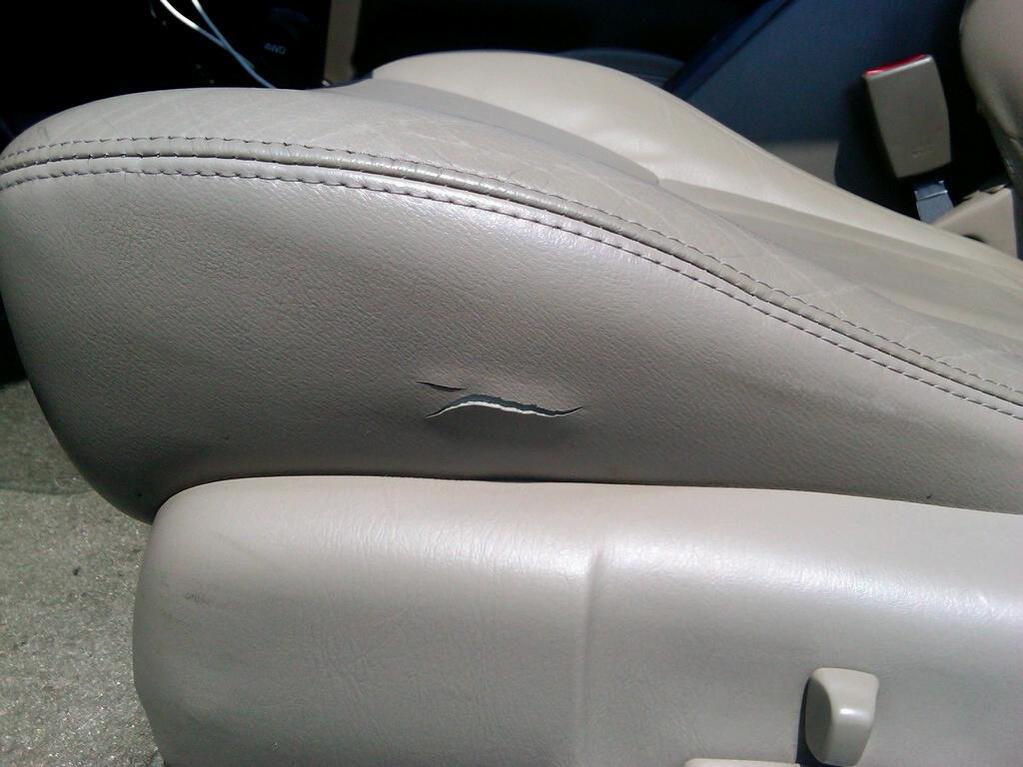

I have the 4runner and I love it. Its getting inspected tomorrow and a new bumper from certifit will be installed early next week.
There is a small ~1" tear in the drivers seat leather. Any ideas for repair? I really just want to prevent it from worsening.

I have a similar looking slit on my front seat. I am planning on using a leather backing patch to put behind the cut, essentially some tape. Then use some leatherique leather crack repairer over the repaired area. They make some dye that I was gonna use on the bolsters and that area. I also planned on switching the drivers seat cushion with the passenger bottom seat cushion.

Get Wet Okole seat covers! lol :bigok:
My driver's seat was beginning so show some wear too. Didn't really like the feel of the leather and wanted to prevent the seat from getting worse so the Wet Okole's solved the problem for me. They are very, very comfy too
