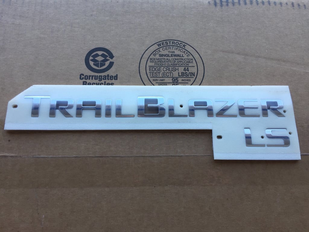

This is a little unorthodox but I was curious to see if it worked and I needed something to test out Plasti Dip on. So here is what I started with:
Cost me $8 shipped on eBay. I liked the font and it kind of matches the 4Runner font on the back.

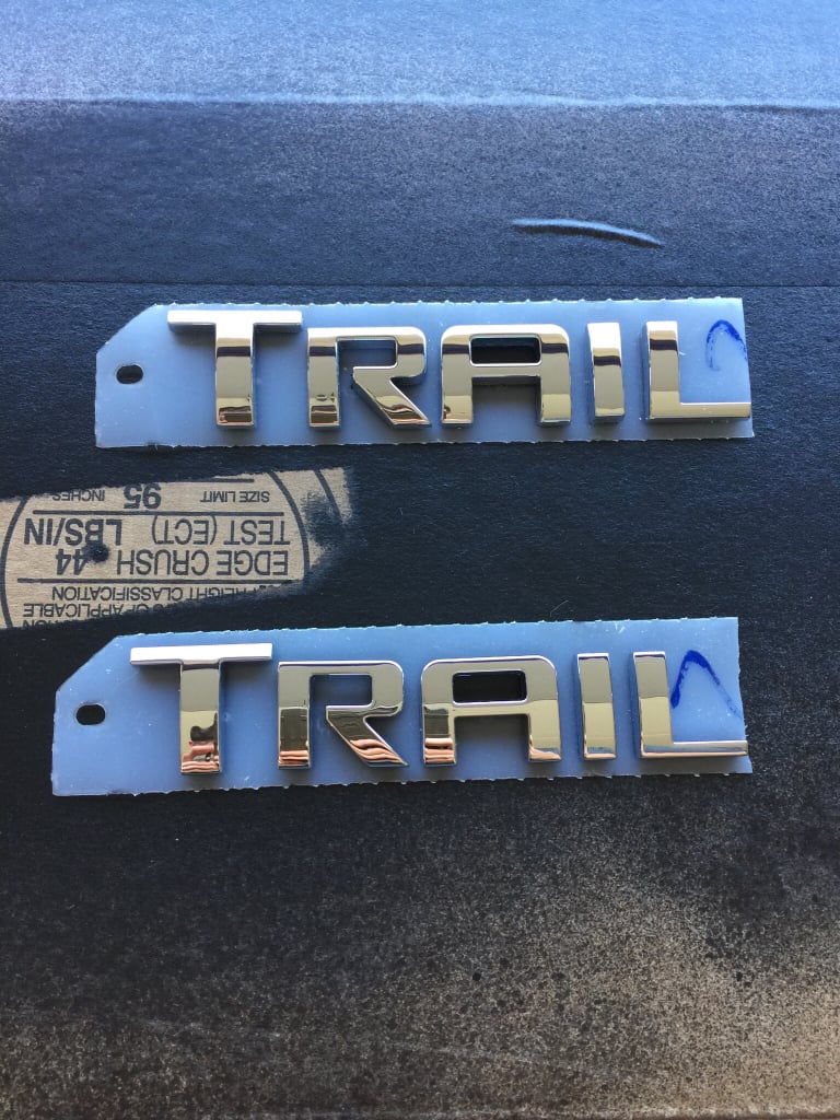

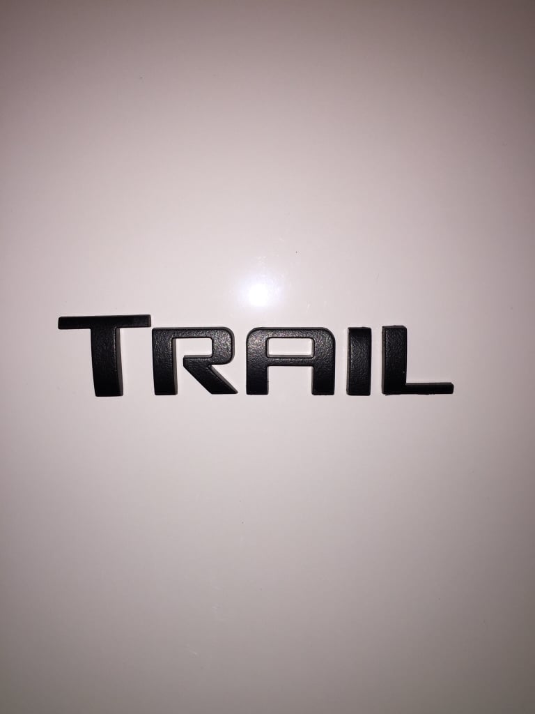

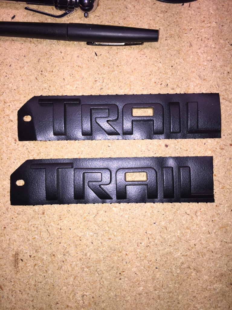

I trimmed off the unneeded letters and sprayed on the Dip. I did 6 coats with 30 min between them. Here was the result.

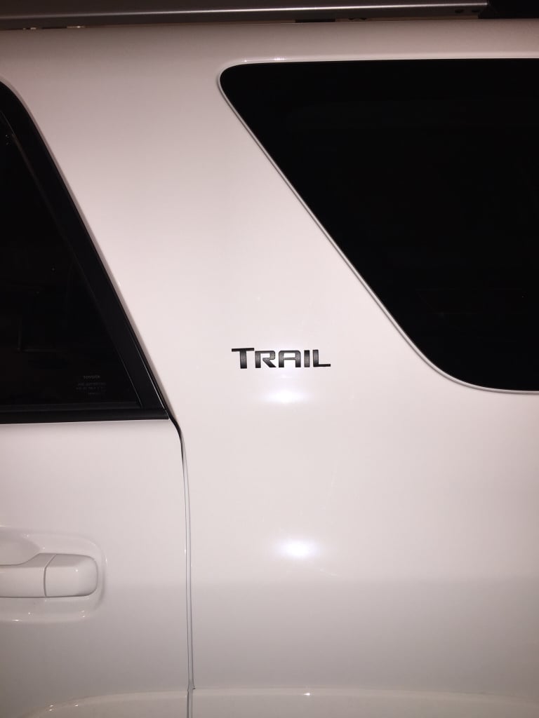

Here it is on the vehicle.
Pretty happy with how it turned out. Just something different which is what I am after. Let me know what you think!
This looks like crap. Like buying fake shoes and knowing the Nike symbol and wording is just off in font and size and everything. If you enjoy it then "rock on' and don't ask for feedback.

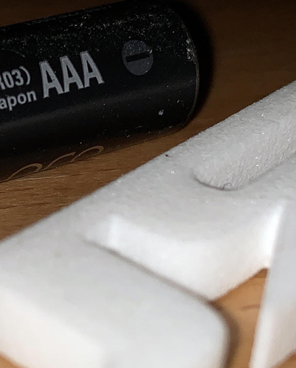

The pic attached is a test print in plain white, it hasn't been tumbled like the premium prints. AAA battery for scale.

Well the material is slightly porous, you can see that in the image I posted above, it is pretty obvious. That is an untreated print, as mentioned.
If you buy the colored versions (for example: Black Natural Versatile Plastic or Premium Black Versatile Plastic) that have been tumbled and coated, that porous surface is covered. Sanding it destroys that prepared surface. You paint it with a filler primer to smooth it out (untreated prints would certainly require a lot more coats). You can wet sand after it has been primed and don't go through the primer. Not sure what to say about the shop you took it to, have they ever worked with 3d printed materials before? The stuff I have seen come out from professional shops that work with printed materials look amazing, so much so you wouldn't know it was a print.
