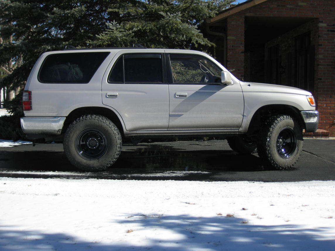

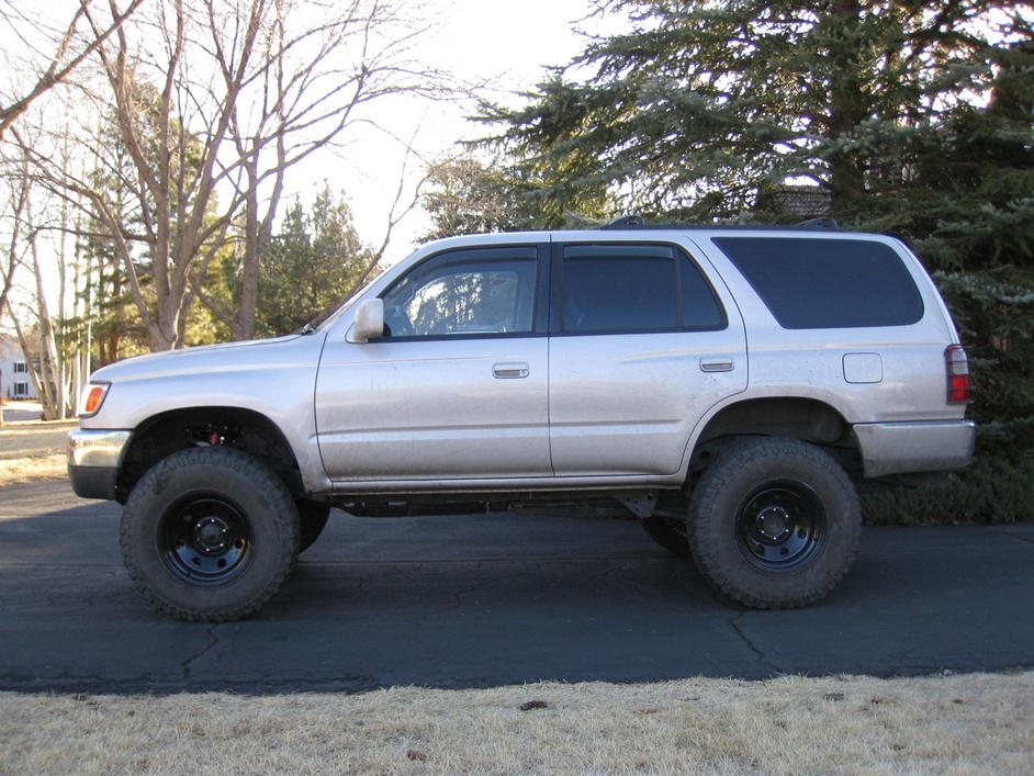

So I got around to getting some 890 coils in the rear. After putting one side on I wasnt satisfied with the supposed 3"+ was suppose to get. It looked like I was only getting about 1.75inchs of lift, def not 3in like they say. My guess is toytec and Old Man Emu spec like 96 or 2000 when them made the mini coils after all the exploders rolling.
Anywho, decided to pull the 890's and reinsert my daystar 1.5in spaces back on top of them. Then I cranked another inch out of my from coilovers to level it out.
Here is before and after, This is a real 4runner now!
