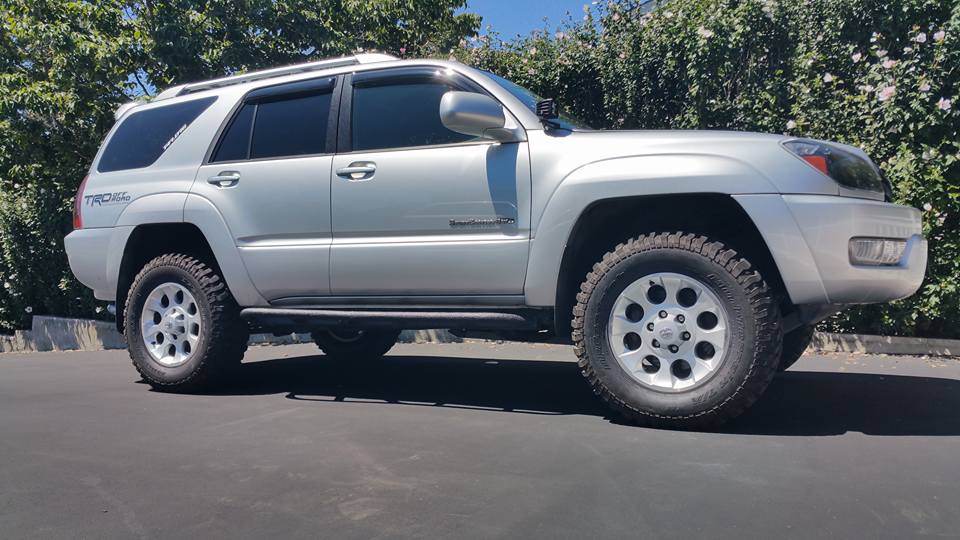

I have this exact set up currently.
Yes you need an alignment and with stock UCA's you will lose some caster causing a slightly light or twitchy feel in the steering under acceleration. You will quickly get used to it and not notice.
You do not need a BMC. You do however need to remove the front mudflaps.
