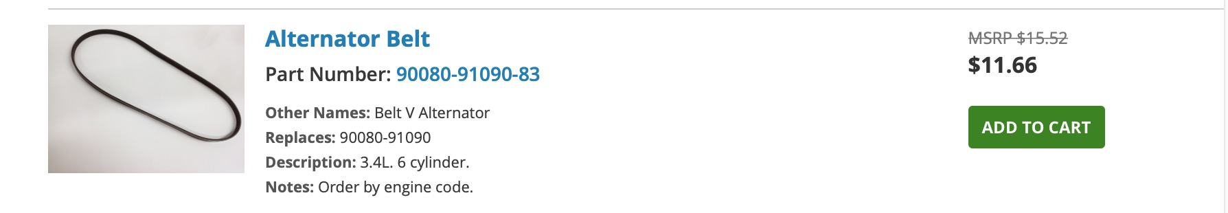

Maybe your computer/device is broken? I looked just now at Rockauto, and then I looked at Camelback Toyota online. I found this pretty quick at Camelback, Rockauto took longer 'cause I'm less familiar with their site:

Used Bando Belts last time on the 5VZ-FE and they seem well made, haven't been happy with goodyear, dayco, or Gates lately, they should be able to cross these numbers over regardless.
Bando 4pk1070
Bando 4pk1050
Bando 4pk870
Thanks for the tips Malcolm99 & Jensen735. The part store near me is telling me it's the same belt for all three and I wasn't sure if that was right, one source I saw listed three different belts like yours Malcolm99. I'll probably have to check with the dealership on what they have since I need the parts today.
