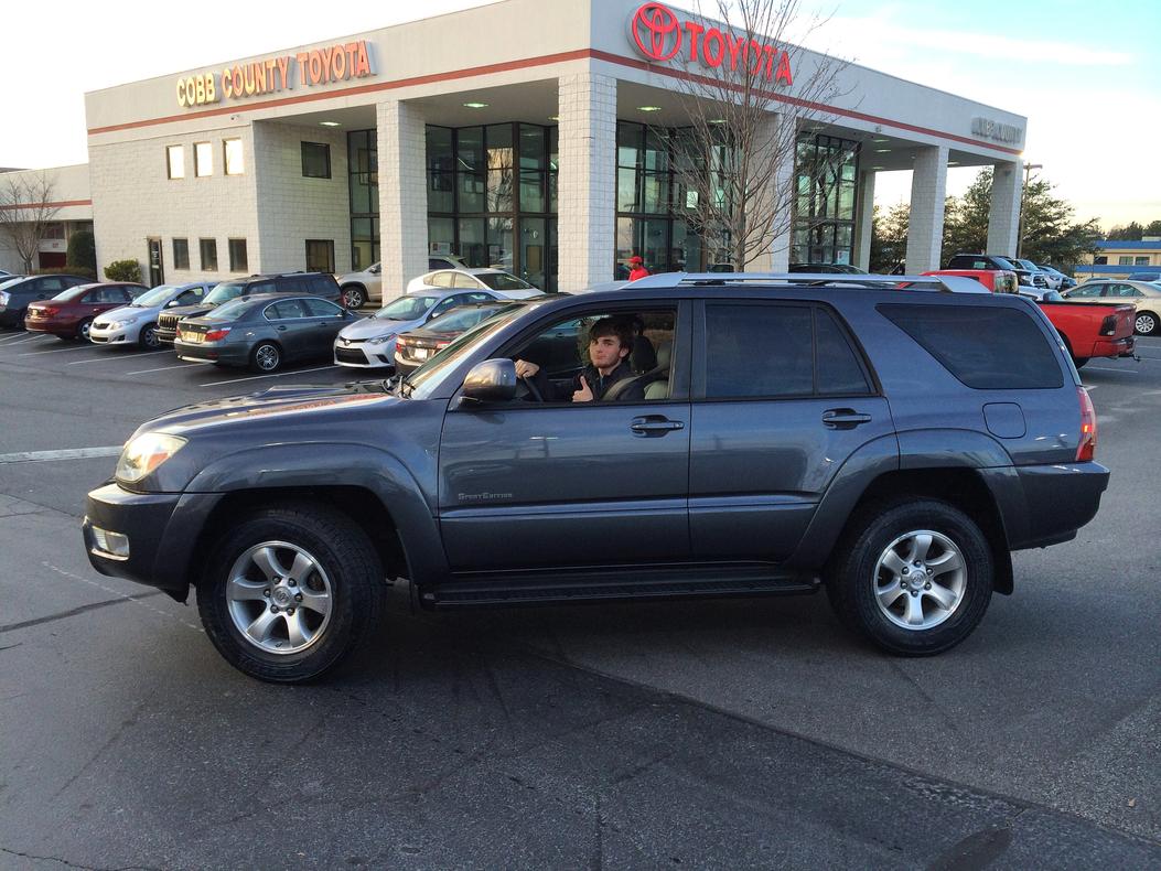

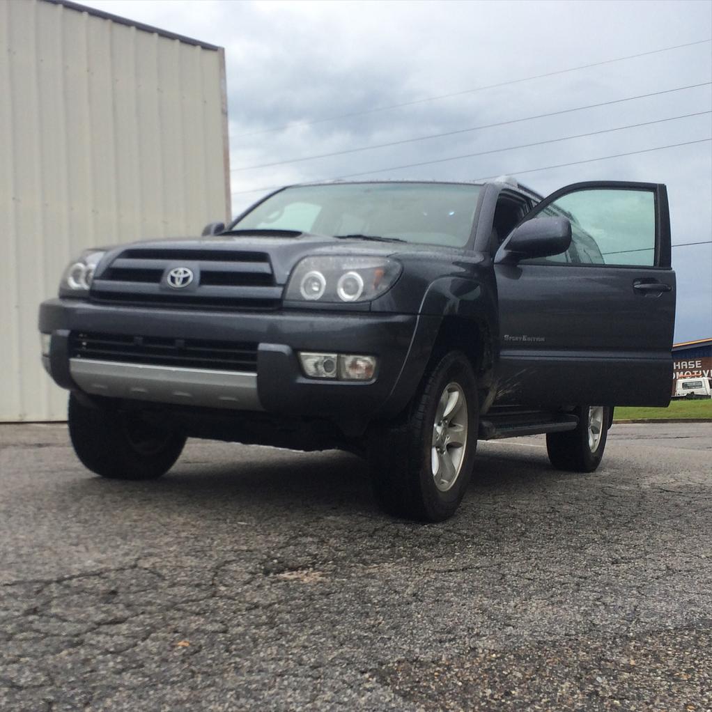

The first picture is from the day I bought it. 2005 Toyota 4runner Galactic Grey Sport Edition 2wd v6 with 152k miles.

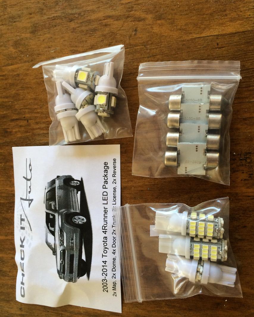

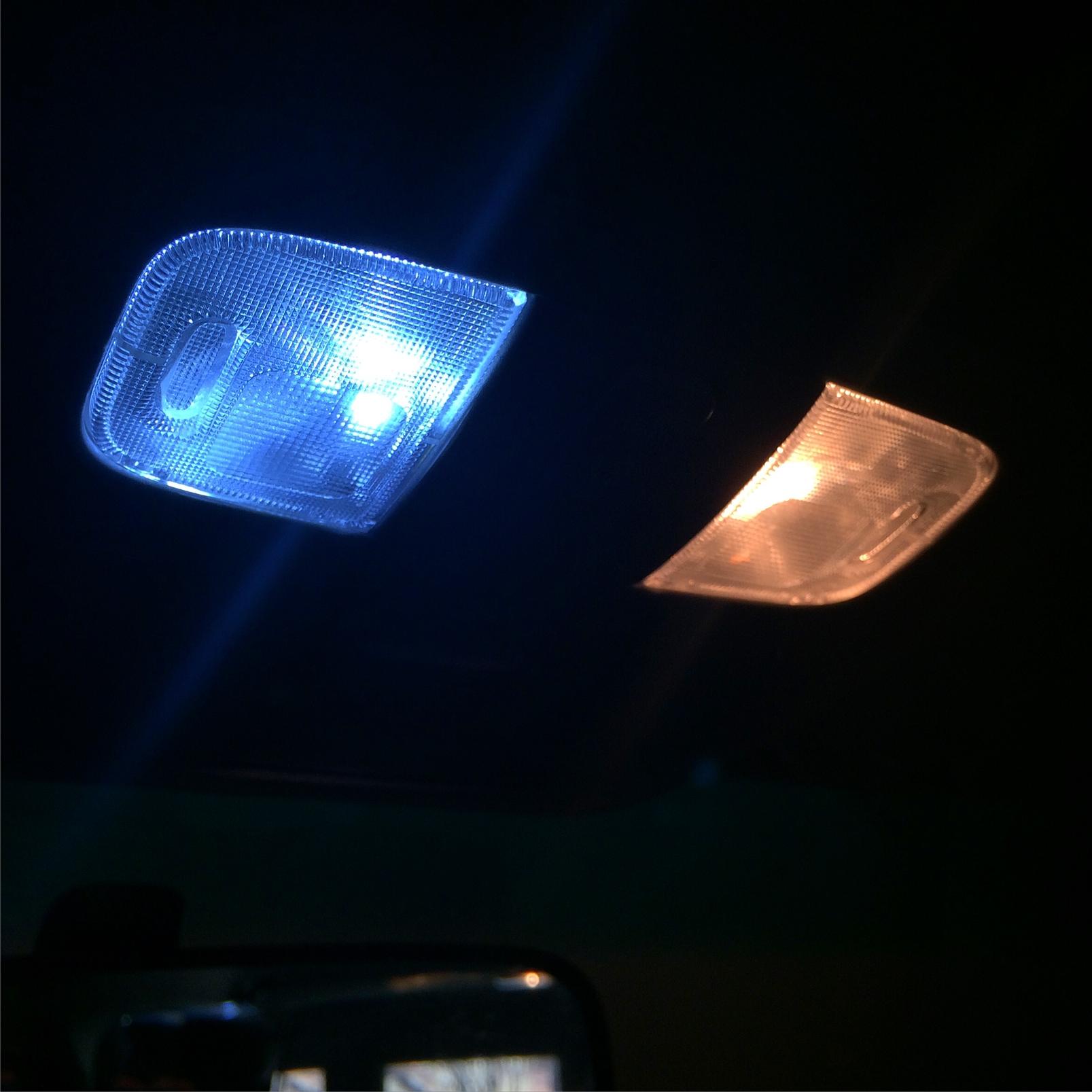

The first mod I did was add Led Lights all around including: Dome lights, Door lights, Reverse Lights, and License Plate Lights
The difference in Stock vs Led:

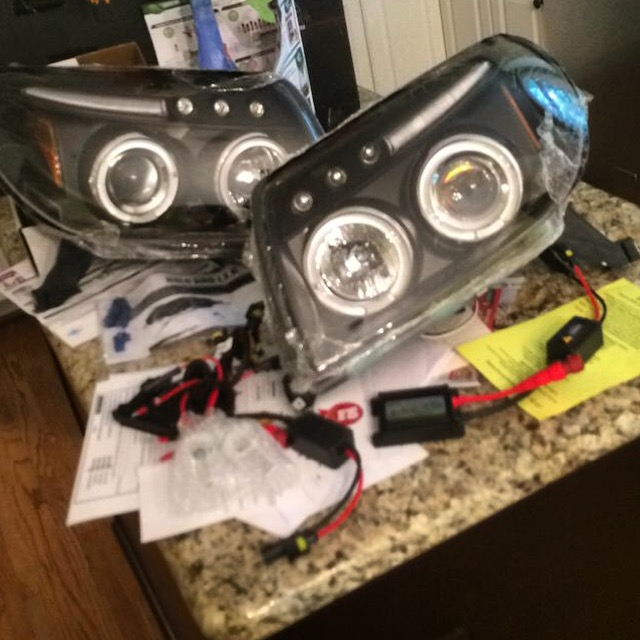

Next up was the Spec-D Tuning Headlights. They came with HIDs and ballasts.

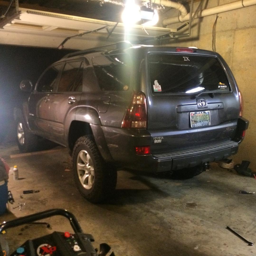

Next up came the Daystar 1" Thick Budget Boost (2" Lift)

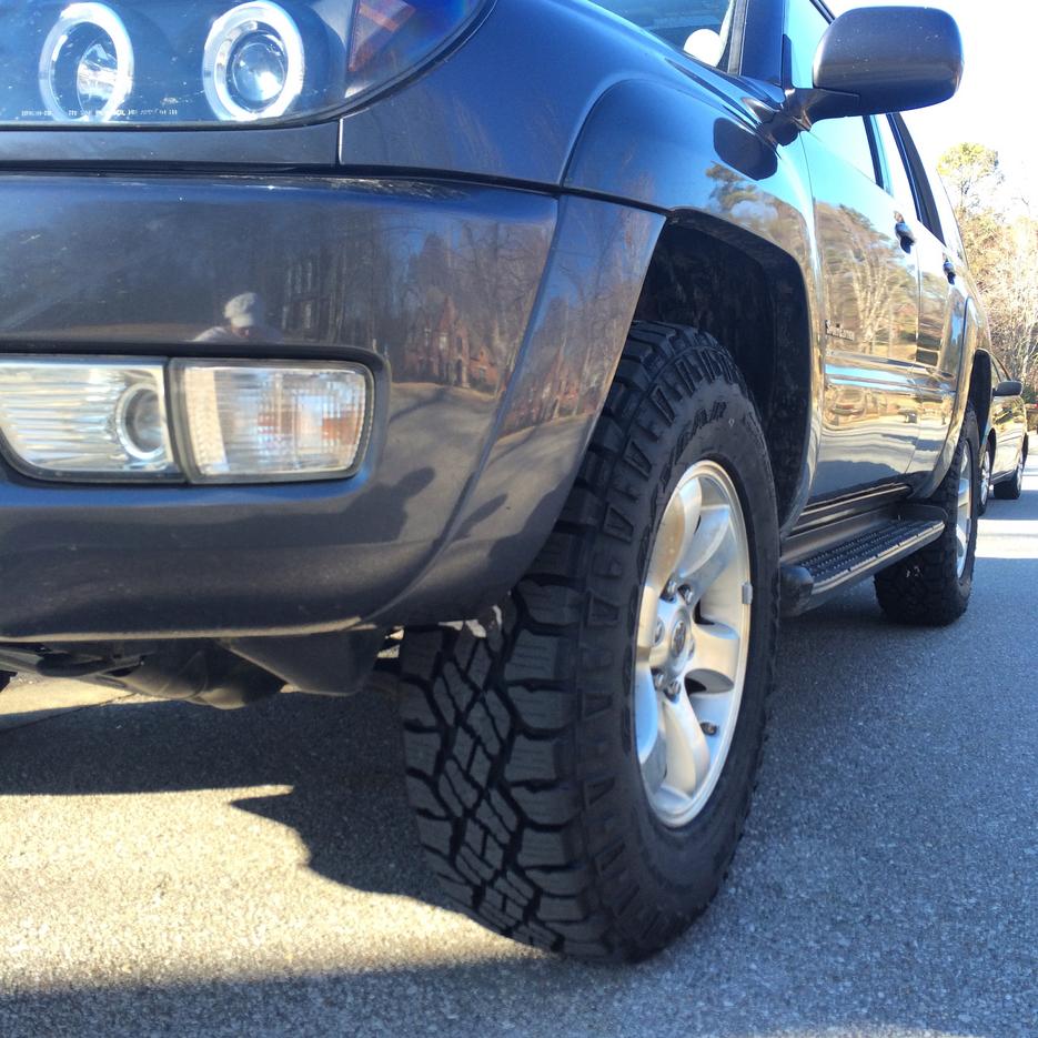

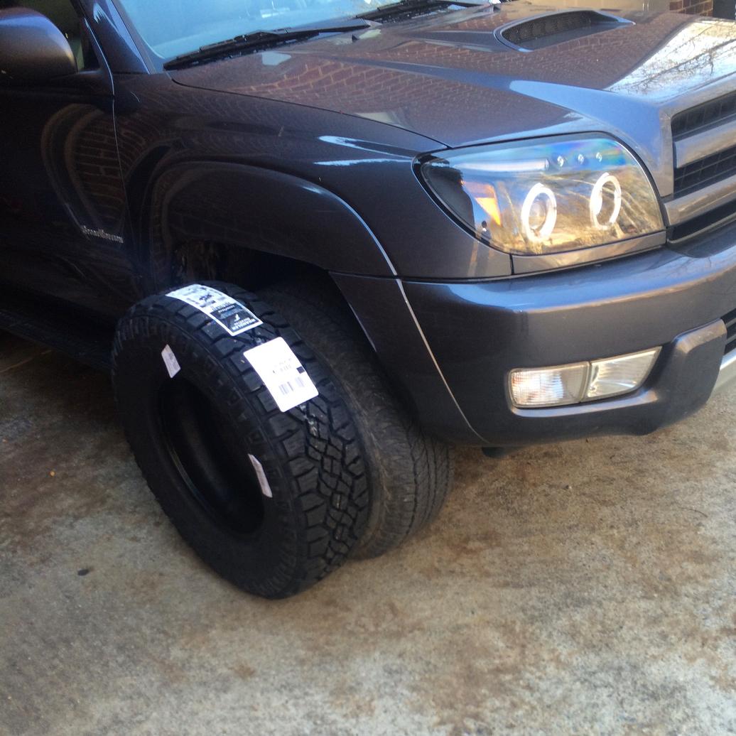

A few months after the leveling kit I figured I should fill the empty space in the front so I added 255/75/17 Duratracs. Got them online for under $700 and Walmart mounted them for $20.

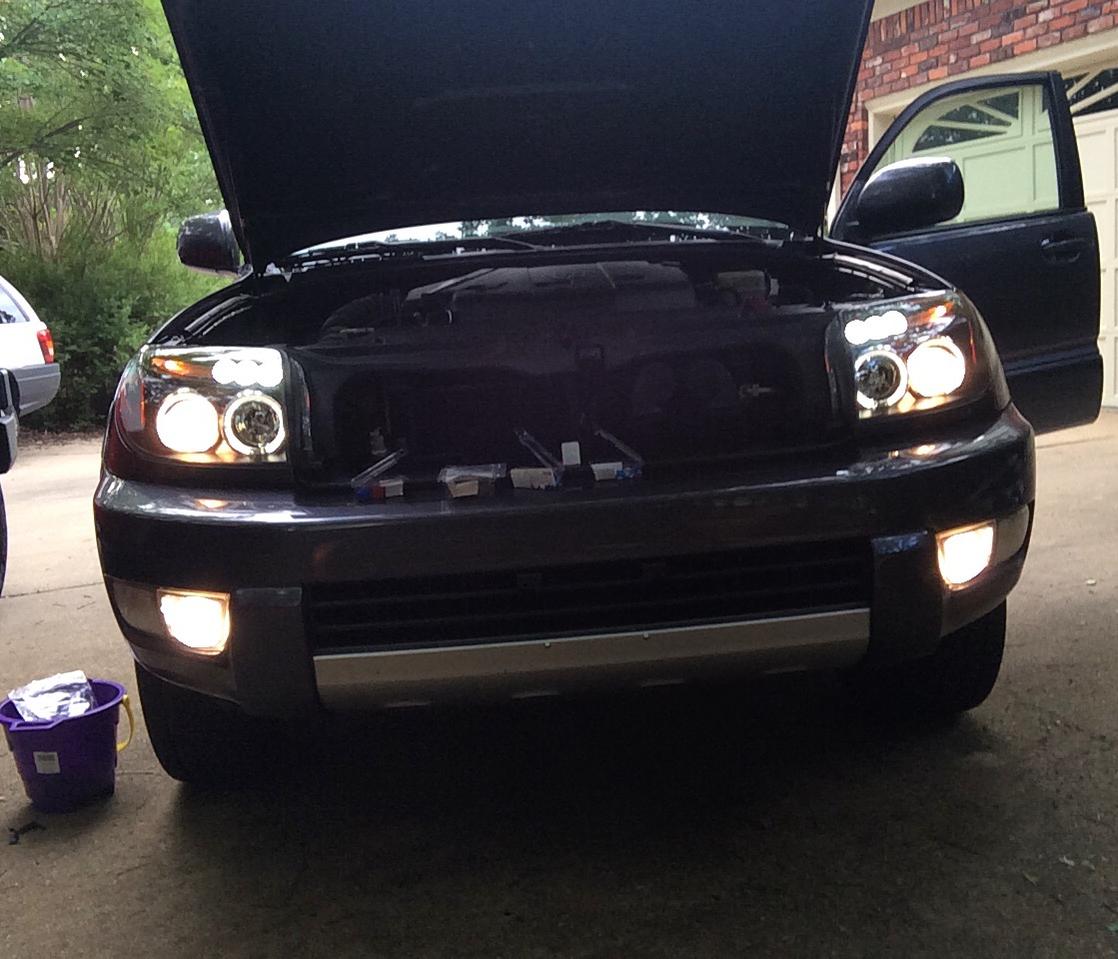

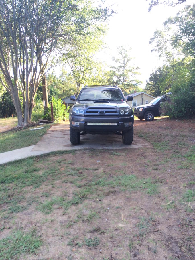

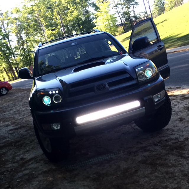

Finally hooked up the HID's that came with the headlights after forcing the stock bulbs out. Many people had this problem with the stock low beam bulbs on Spec-D Headlights. Also bought a 32" light bar to put in the lower grill. Couldn't find an easy place to mount onto the frame so I rigged up something with the stock mounts facing out. Added a LED LIGHT BAR rocker switch inside which looks pretty neat and factory. Also had my front windows tinted 20% with a 5% windshield strip.

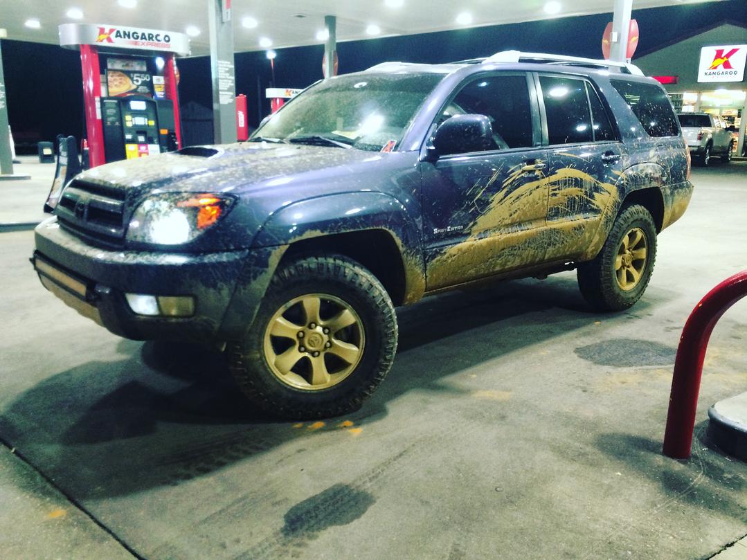

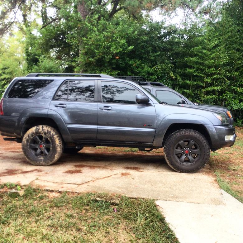

Tested out the light bar a few nights after I got it. Ended up hitting a few mud holes and blew a few fuses for my light bar.

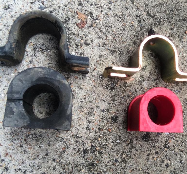

I've had swaying problems for awhile now and have been taking everything into account. One thing I was told to do by a member was to change out my Sway Bar Bushings with Polyurethane bushings because OEM rubber ones wear out. I replaced front and rear including sway bar end-links. Heres a comparison on stock and Prothane Bushings:

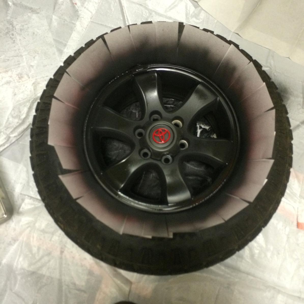

After Plasti-dipping the roof rails and bedlining the silver parts on the front and rear bumpers, I decided to see how I liked black rims. I did multiple searches for Sport Edition rims but found few that I liked. I went ahead and did it anyways and painted the Toyota emblem red. Couldn't be more happy. Now to either get wheel spacers or wider tires.

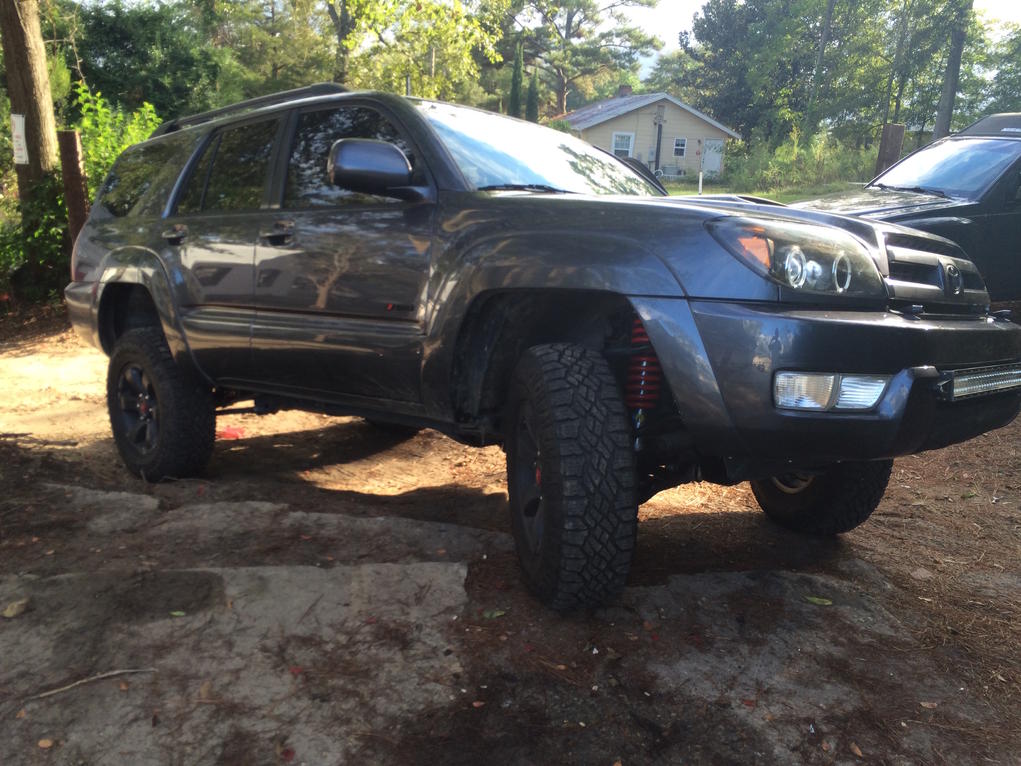

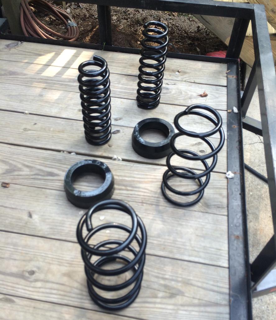

I bought Moog 81088 Coils which apparently lift a V6 RWD 4runner just shy of 2". Painted them red for looks and paired them with Bilstein 5100's. Solid looking combo in my opinion. Set the bilsteins at 1.75" and added Moog top plates.
attachment.php
attachment.php
Finally got around to installing them. Assembled the struts the night before the install and got a buddy to help with the install. Disconnected the sway bar and let it freely sit without removing the skid plate. Dropped the LCA off of the hub by the 2 bolts holding them together. Stock struts came right out and disconnecting XREAS was a breeze (oil went everywhere!). New struts went in easily but they were so stiff that cranking up the LCA to get the tires back on was nearly impossible. Took about 5 hours with a buddy including assembling the struts the night before. I have spent hundred of hours on the forum researching how to do everything but actually doing it was a different story. Drivers side took about 2 hours and passenger was probably 40 minutes just because I knew what I was doing then.

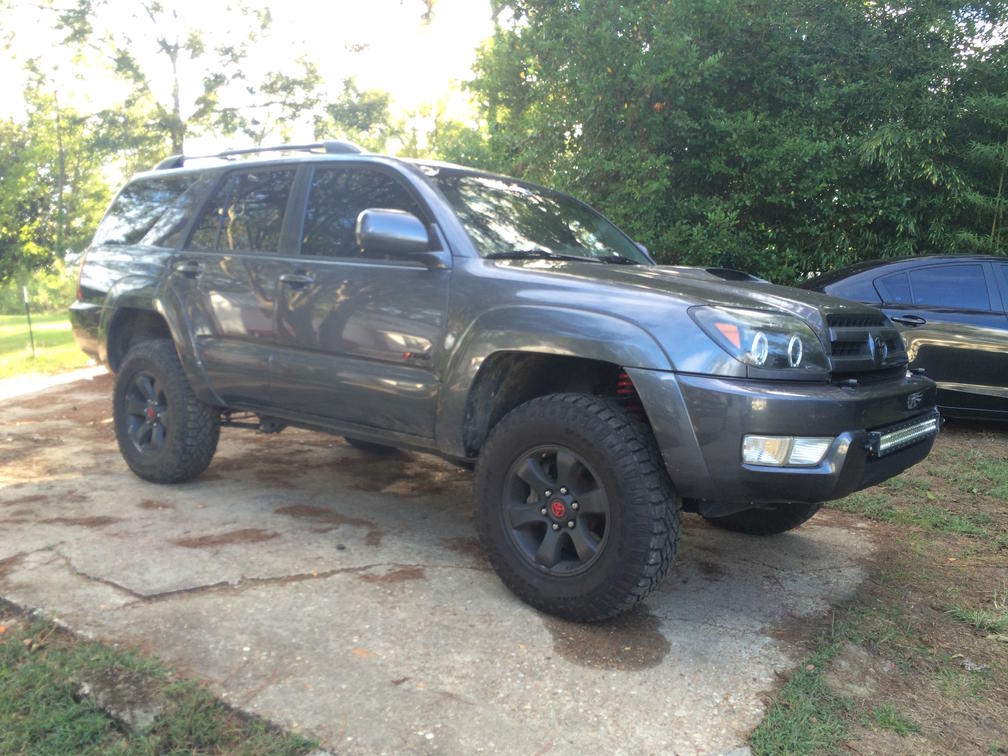

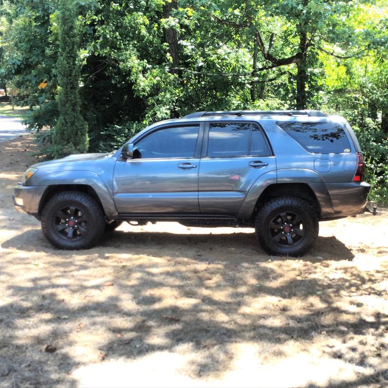

Just had my alignment done. They obviously couldn't get it into spec but thats ok. Here's a few daytime pics of after the lift installed.

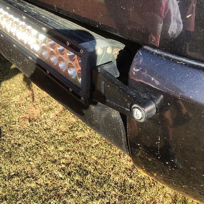

Lower Grill Light Bar Mount
For anyone wondering how I mounted my light bar in the lower grill: this is what I did. I used the stock mounting brackets and turned them sideways. The part of the bracket that usually mounts to the bumper or vehicle is actually attached to the side of the light bar and where it usually attaches to the side of the light bar is attached to the bumper. I like how the light bar sits also because the beam is outside of the bumper and doesn't lose light output from the top of the bumper where if the light bar was inside the grill. Also the install of this method is super easy and only takes the time to drill holes into the bumper. The longest part was taking out the plastic inside the grill. I love how it looks and performs. Never had a problem with a rock hitting it or coming lose. The bolts in the bumper have held up pretty good also and the light bar doesn't bounce around or shake when driving down the road or offroad.
