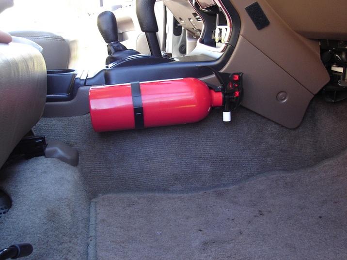

I mounted mine like this. It has held solid for 3 months now without bending the plastic piece it's bolted to at all. The only time I have to remove it is if I want to move the passenger seat all the way forward. It doesn't affect passenger comfort at all--and I've sat there plenty when my wife drives.

Im diggin the placement, easy access!! :flamethrwoer2:
Thanks. It really works--seriously not in the way at all, and a sturdy mount.
I chose there just because someone was saying they'd love to have it in reach if they were pinned in an accident and there was a fire. Well, I suppose it might not help much in that situation, especially if there were an engine or fuel fire, but it's better than not having it there IMO. Hope it never gets used, but I like having it. Plus it might save my interior if a flicked cigarette ends up in the cargo area instead of in a puddle, lol.

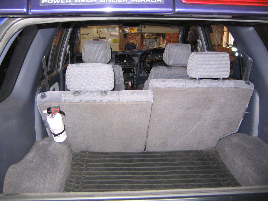

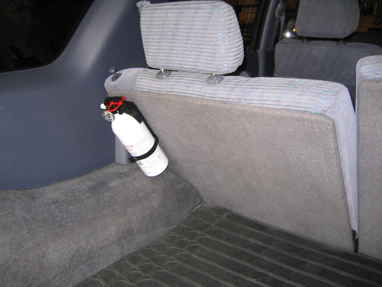

I grabbed a Kidde Auto/Marine fire extinguisher from Mennards when we were down in the US this weekend, and mounted it to the rear of the 2nd row seatback, the little bracket that comes with it is pretty slick.

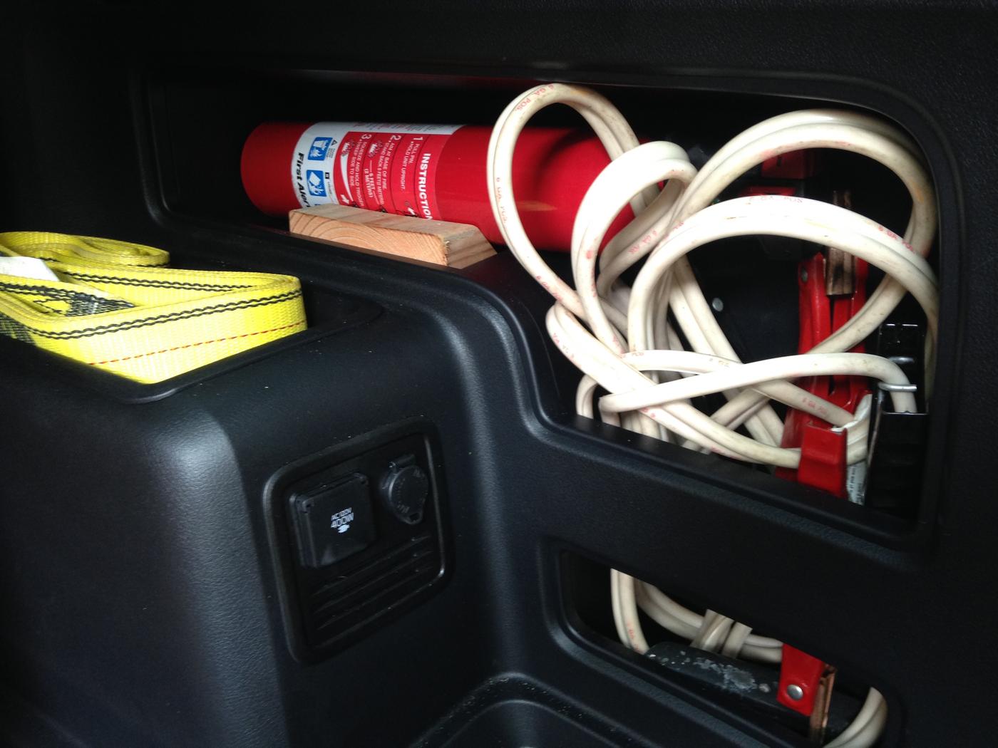

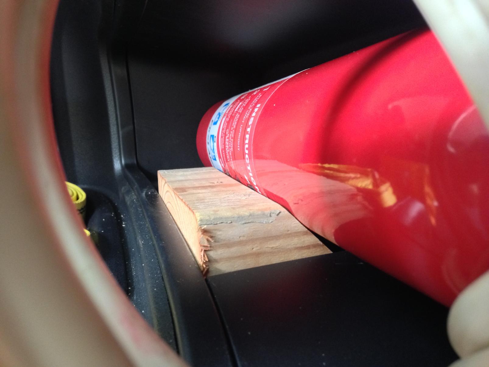

Some really excellent suggestions in this string for mounting fire extinguishers. I just sold my 2003 4Runner Sport edition, loved that thing, and purchased a 2018 SR5 Premium. I looked through all these good ideas for where to put a fire extinguisher in the new one, as mine was just banging about in the back despite rolled up in some towels - not good! Then I discovered a ridiculously simple solution for these new 4Runners - there's a place to stick a fire extinguisher in the back right IF you brace it in with an angled piece of wood. Using my compound sliding miter box saw, I cut a 45 degree angled 2" x 6" board, for me 3" long at the longest point, and just put that in the little shelf/compartment in the back right. That made the fire extinguisher real snug, and its stability is assisted by my jumper cables right next to it. There's space above the fire extinguisher, so you just lift it up a bit and it comes out over the wood when you need it. I'll modify this post if it doesn't work out OK, but on some initial drives the extinguisher stayed in place just fine. And obviously if your extinguisher is fatter, make the wood piece 2.5" long, or whatever works. Now I'll sand the wood and paint it black...
