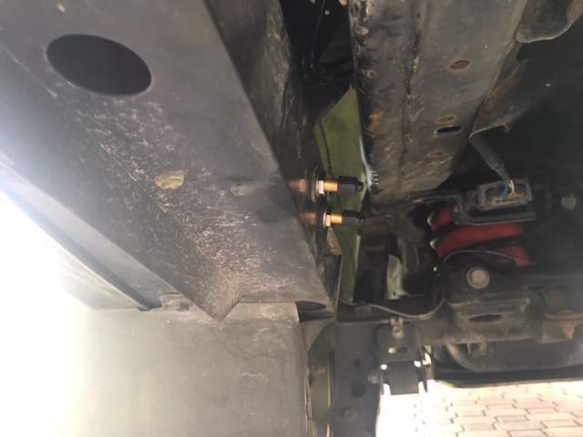

Not mine - but this is where I put mine only on the passenger side.

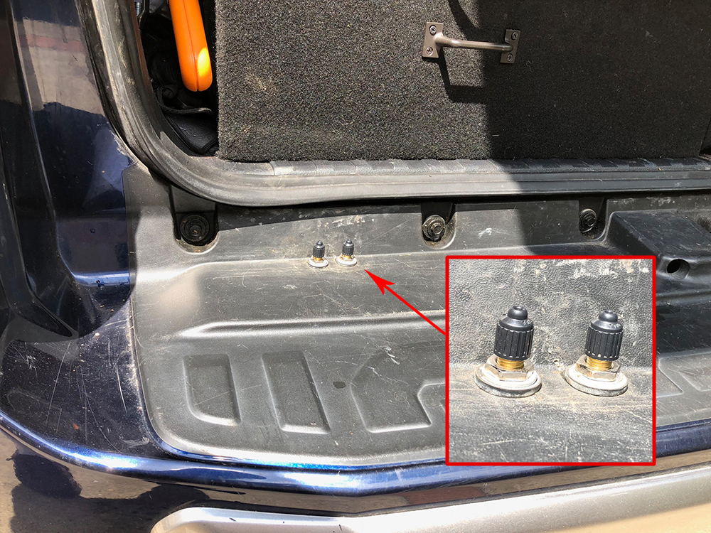

My only concern with above the bumper is introducing a rust point. Any issues over time?
No problems. It's all plastic there, so no rust concerns. And it's easy to go back if you want to remove. Two barbed push rivets would cover the holes pretty easily. Or you could replace the the plastic bumper trim piece.
The location is inside the rear door edge, but outside the door seal. Its not totally protected from dirt and road grime, but mostly protected. So they stay pretty clean.

Used Airlift bags and ran the valve to the top of the bumper under the liftgate as someone posted earlier. Single valve though split to both bags. I've had it since November and no issues yet. Super helpful when loaded up or towing!
