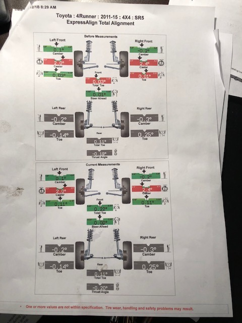

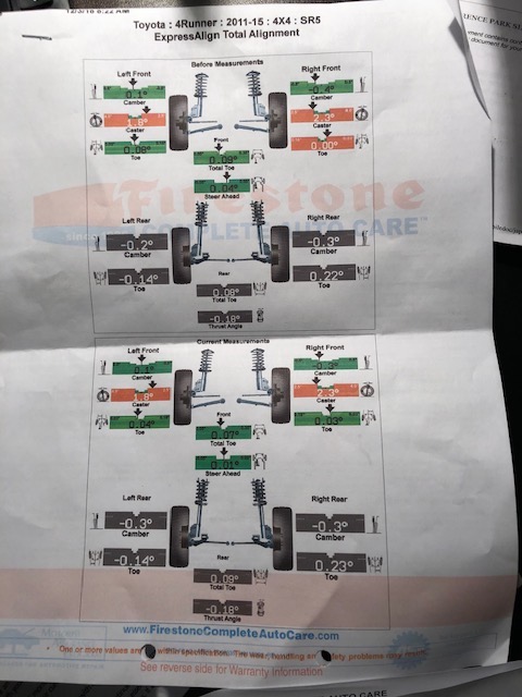

Took my car into Firestone because my car was pulling to the left. I purchased the lifetime alignment.
Took the car back this morning because the car was still pulling to the left.
Took it in to see if the can correct it and get my caster as close to +2 and as even as possible. This is when they informed me that the right eccentric bolt was just spinning in the adjuster and there was nothing they could do about it. Any help in what I need to do to get this corrected? Would this fall under extended warranty? Take it to the dealership? Could they have damaged the bolt?
Todays spec sheet has the 2.4 caster on the right front.
Thanks in advance for any help.

From what I understand the toe doesn't affect which way your steering pulls. But it does affect if your steering wheel looks centered or not when going straight.
Left / Right pull is affect by camber and caster. The vehicle will pull to the side of least positive caster. So going by your alignment specs the low positive caster on the left side is causing your vehicle to pull to the left.
I had the opposite problem. My T4R when new pulled to the right. The dealer only adjusted the toe and it didn't really do anything to improve this. They re-did the alignment and added more positive caster to the right. This fixed my pulling problem.

For some reason my original post was completely messed up by either Siri or spell check. Regardless, pulling it into Toyota in the morning to get it figured out. Firestone didn't hesitate in giving me my money back immediately. It was actually the way the manager approached the situation. I'm just a bit confused thinking something is wrong with the eccentric bolt?
It’s not unusual for people to replace the cam bolts. But often it’s because they’re seized and need to be cut out.
Good luck. I wonder if the tabs the cams engage to are damaged...?
Keep us posted with the result

Quick update here.....Firestone stinks.
Nothings broke, Toyota was able to get it as good as they can with 2.3 positive camber with the Bilstein 5100's on at 1.75 lift. Everything else is within spec. Ever so slight mis-alignment on the steering wheel that the tech wasn't sure if he could work out without leading to him spending a ton of time trying to fix. Said I really shouldn't notice it. (but he doesn't know me)
